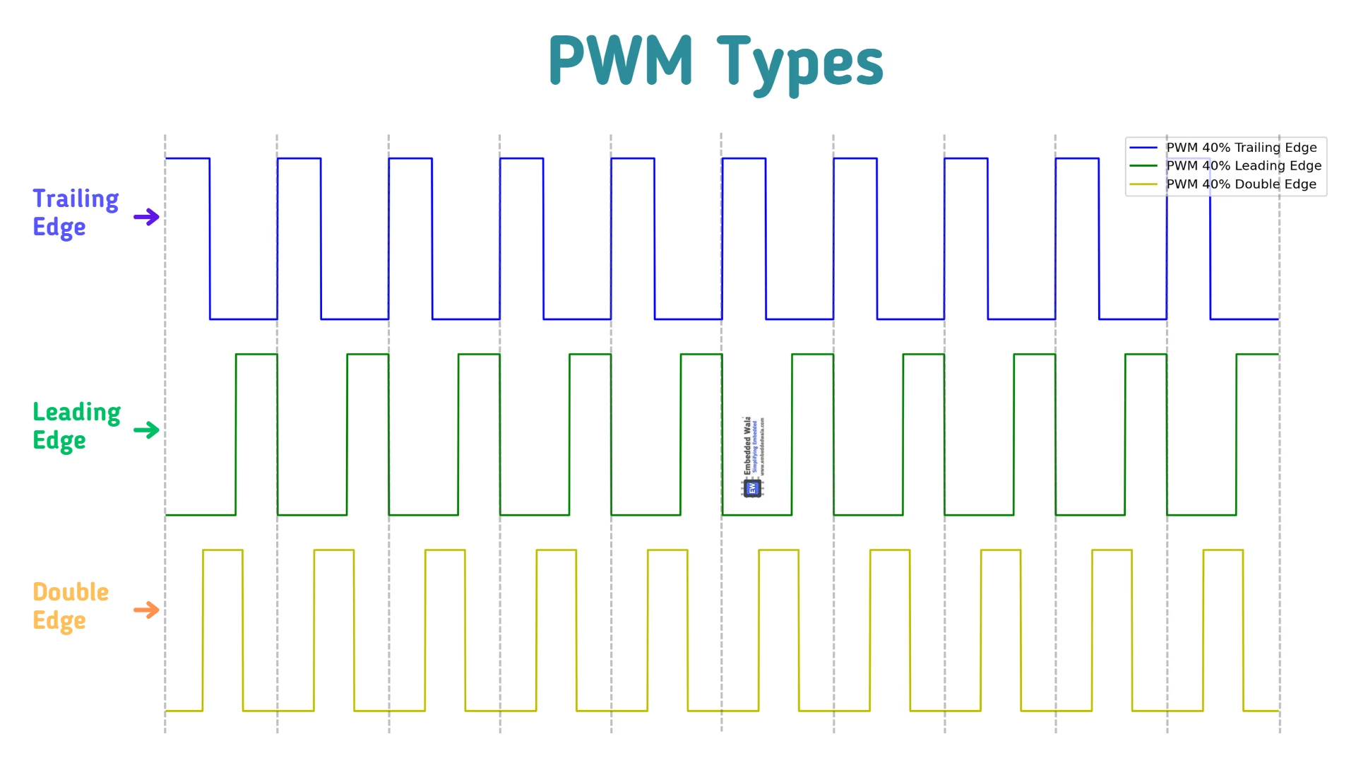

So the normal operation of PWM with a trailing edge is working (see attached image for seeing the waveform).
Now I want to adjust parameters to get - based on same frequency and duty cycle - the leading edge pwm wave form.
What needs to be adjusted on the sConfigOC, or what else needs to be adjusted / manipulated if I switch from trailing edge to leading edge?

sConfigOC.OCMode = TIM_OCMODE_PWM2;

Anything else to be considered?
E.g. _PWM[ch].TimHandler->Init.CounterMode = TIM_COUNTERMODE_DOWN;
August 7, 2024
I think you need to change the pulse value and the polarity.
 sConfigOC.Pulse = 500;
 sConfigOC.OCPolarity = TIM_OCPOLARITY_LOW;
Your current waveform is 50% duty cycle, so changing the pulse doesn't do much.
