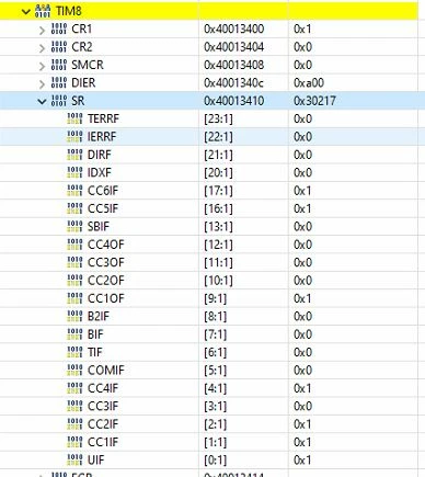

Hi All,
I am setting up TIM8 CH1 and CH3 on a STM32G431 and am seeing a strange result. First of all, I am using an external signal coming in on PC6 TIM8 CH1. For TIM8 CH3 I am only using a software trigger internal to the MCU, I'm not using any external pin for TIM8 CH3. I am looking for a input capture on CH1 and CH3 only.
First. is this configuration okay for the G431?
When I enable TIM8 I immediately get SR bits set on : UIF, CC1F, CC2F, CC4F, CC1OF, CCI5 and CCI6. I expect the result for CC1F and CC1OF as CH1 input is active.
Is there something I need to do in initialization to make sure erroneous flags don't get set on an enable? Would any of these erroneous flags interfere with the DMA I have set up for CH1 and CH3?
I dont' know what do you exactly mean by "when I enable TIM8" but CC channels which you don't set explicitly are by default set as Compare and their respective CCRx is 0, so when the counter is enabled (TIMx_CR1.CEN=1), the first time timer "goes around", those CCRx match CNT and the respective TIMx_SR.CCxIF is set (that's probably what you've meant by "CCxF" and "CCIx", as none of those exist). TIMx_SR.UF is set at that time, too; but probably it has been already set by the Cube/HAL function you use to set up ARR/PSC, as it generates Update explicitly by setting TIMx_EGR.UG.
So there's nothing "errorneous" in this behaviour, the timer works as described in RM.
Channels, for which you don't set the respective TIMx_DIER.CCxDE bit, don't influence DMA. Additionally, in 'G4, each individual TIMx-originated DMA trigger signal has an individual input to the DMAMUX multiplexer, see Table 91. DMAMUX: assignment of multiplexer inputs to resources, so individual TIMx sources can't influence each other.

Thanks for the information. By "enable TIM8" I meant TIM8->CR1 |= TIM_CR1_CEN;
If those unused compare flags being set is not a problem then I will ignore them. Attached is a snapshot of the TIM8 SR register while debugging this.0693W00000AN77eQAD.jpg
