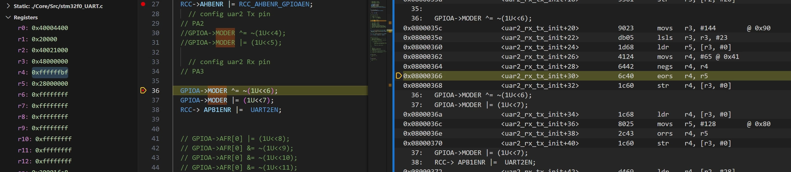

I am trying to build a uart implementation from scratch to learn the Stm32, but such a code implementation seems to cause my Stm32F030 to go into Reset_Handler state.
What might be wrong with my code? Thanks in advance!
At which line?
JemegenAuthor
April 1, 2024
I tried to attach my debugger and I can tell this code is causing reset:
 GPIOA->MODER ^= ~(1U<<6);
To be exact, it's command at 0x08000368

waclawek.jan
waclawek.janBest answer
April 1, 2024
^ means XOR. You probably want &, i.e. AND.
JemegenAuthor
April 1, 2024
It works! Thanks for your help!
