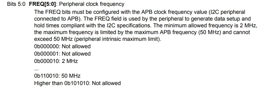

Setting peripheral clock same as the APB1 bus clock following the data sheet which is 42MHZ .It's from bit 0 to 5 on I2C control register 2.To what bit do I set it to?

Hello @Marrkinho​ ,
To set the peripheral clock frequency for I2C as APB1 frequency (for 42 MHz ) , you need to program the bits 0-5 (FREQ[5:0]) of the I2C control register 2 (I2C_CR2) as 0x2A. (following the RM)
0693W00000aHaphQAC.pngHope I helped you!
