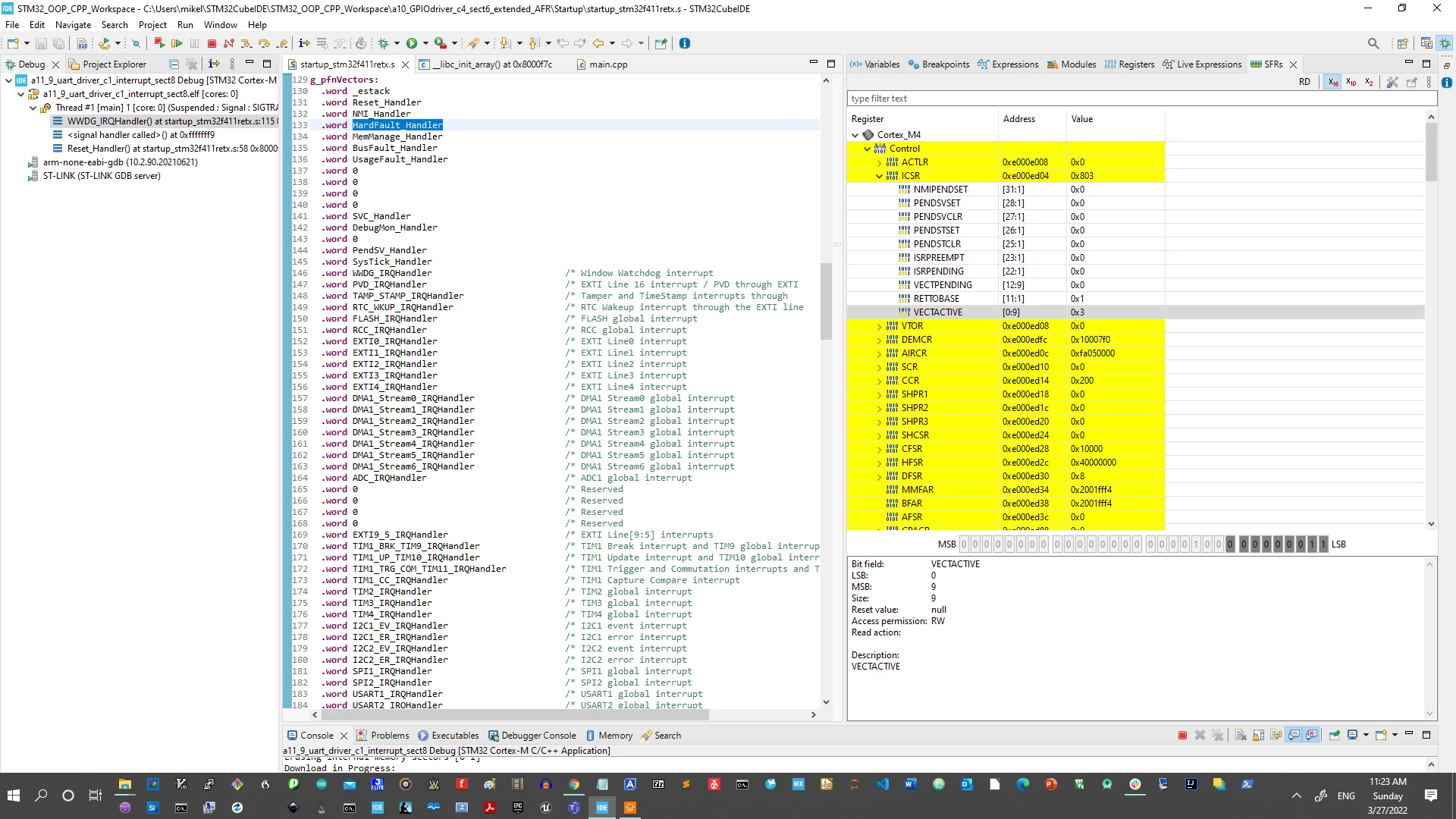

When it's in the infinite loop, pause and examine VECTACTIVE field to see which interrupt it's in. If it's USART2_IRQn, then the linker doesn't see your function correctly. C++ or C? Verify vector table entry for that IRQ points to your function and not the default handler.

VECTACTIVE = 3 (Is it HardFault_Handler?).

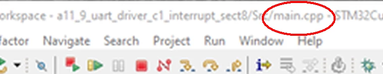

I am using C++, STM32CubeIDE

Yes, 3 indicates IRQn_Type of -13 which is a hard fault.
I don't think any of the code you've presented would cause a hard fault. But in any case, if it's repeatable, you can step through to see which line causes it. You can also examine the hard fault registers to find the offending instruction.
You can step through at the disassembly level to do individual instructions if necessary.
Looks like CSFR indicates a UNDEFINSTR flag.
If using C++, you need to ensure USART2_IRQHandler has C linkage by using extern C. Unlikely to be the issue here.

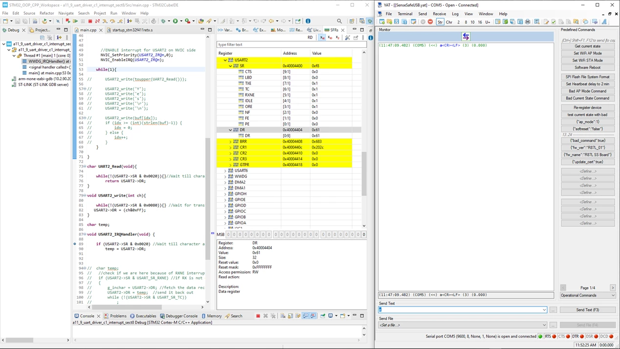

It jumps to 54 or 0x36 (USART2_IRQHandler).
184-130 = 54 or 0x36 USART2 IRQ Handler
VECTACTIVE = 0x36
0693W00000LvtUEQAZ.pngUSART2->RXNE flag = 1,USART2->DR= ‘a’

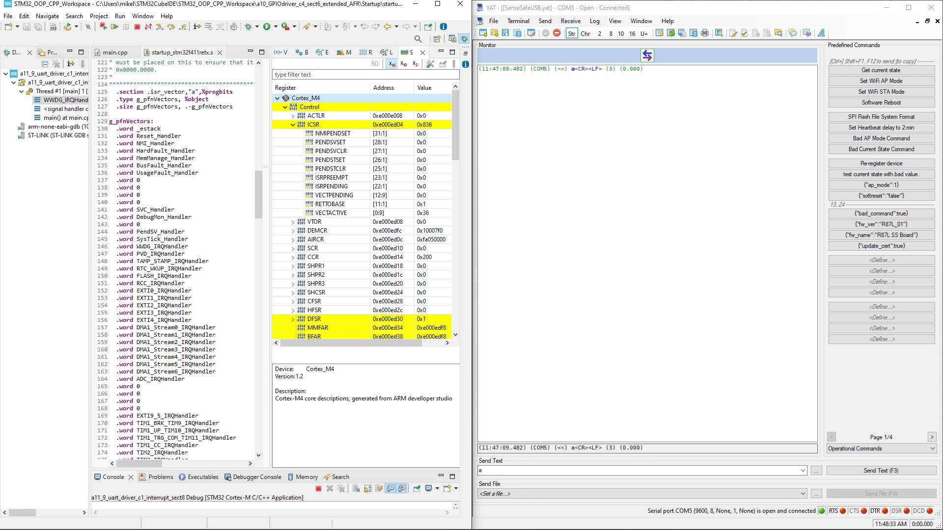

0693W00000LvtUxQAJ.pngAfter this, it jumps to the infinite loop. USART2->DR = 'a' (always). It looks that it can't jump to my ISR subroutine for some reason.

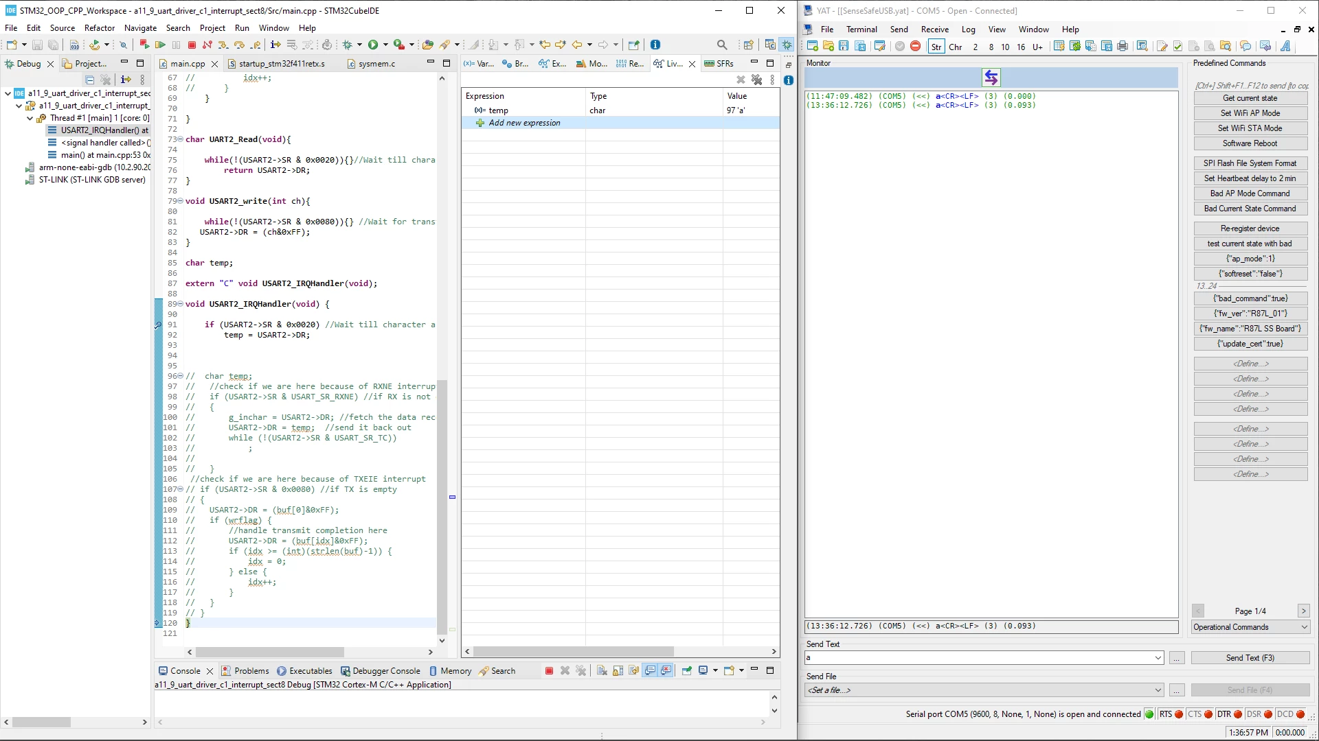

It finally works. Thank you to TDK and waclamwek. Now the program will stop at the breakpoint inside my ISR. I can get the letter 'a' character. I am creating classes for GPIO and UART in my bigger OOP firmware, so I must use C++ here. That is the reason for using C++.
extern "C" void USART2_IRQHandler(void);
I have also learned why extern C is so important to use in this case. In C++, the function is often overloaded with multiple parameters. C++ compiler will alter the function name to distinguish these overloaded function names according to the stackflow post.
Thus, the ISR function name linkage is broken in my usart2 example. The program cannot jump to my ISR routine because it cannot find the matched name. Extern C will solve the problem by preventing the function name to be changed by the C++ compiler. Now the linkage is preserved that the interrupt vector can call upon my ISR function.
