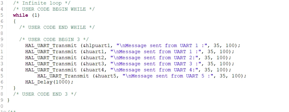

serial port not work
i am using stm32l4r5zi microcontroller .i have enabled all uart port 1,2,3,4,5 but this is not showing data on usb serial port .does l4r5 usb serial port not supporting ?

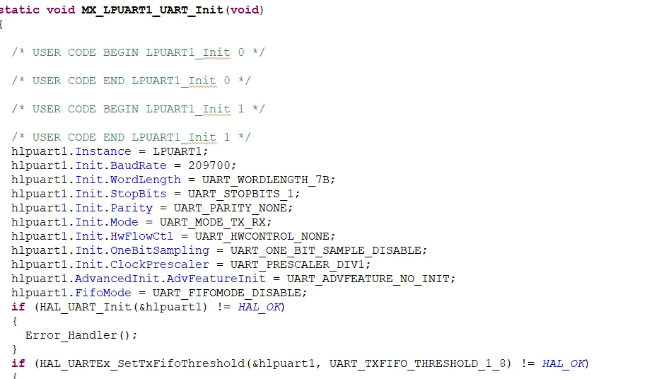

    i have also change the baud rate in LPUART1 ,(209700 to 115200 ) but data not showing

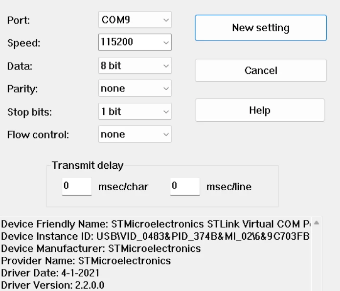

    What board? How is your UART conected to your PC? Check the schematics; you will see which pins are connected to the UART interface. Setup the UART in CubeMX, double check that the proper pins are selected for it.
    what now ?? use serial port on pin..xx OR usb /CDC driver as usb device ?

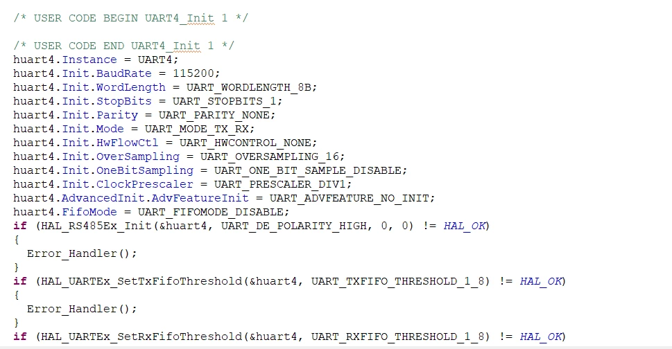

    Why using 7-bit mode?
    Mismatch in bit and baud modes of terminal vs UART.

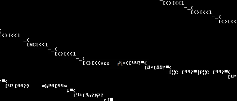

    Don't use internal HSI/MSI RC clocks with that high baud-rate UART or try to slow down (to 9600 or lower). If you are using NUCLEO-L4R5ZI, the HSE oscillator is not populated. You have to use the MCO output from the ST-Link by closing SB109 and SB148 and setting HSE in bypass. That is what I experienced not a long time ago on the other L4 NUCLEO board. -wq
    gbm
    April 15, 2023
    Not a problem. MSI may be synchronized to LSE, which is populated on Nucleo boards.
