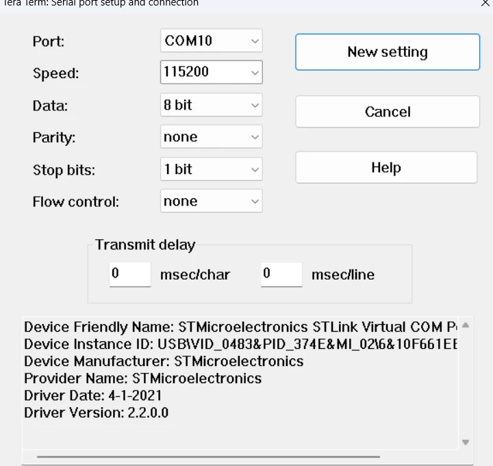

Please check the UART Parameter Settings and the serial port parameter such as Baud rate, Word length, Parity and Stop Bits.
I advise you to take a look at this wiki page: Introduction to the UART I/F on NUCLEO-L476RG.

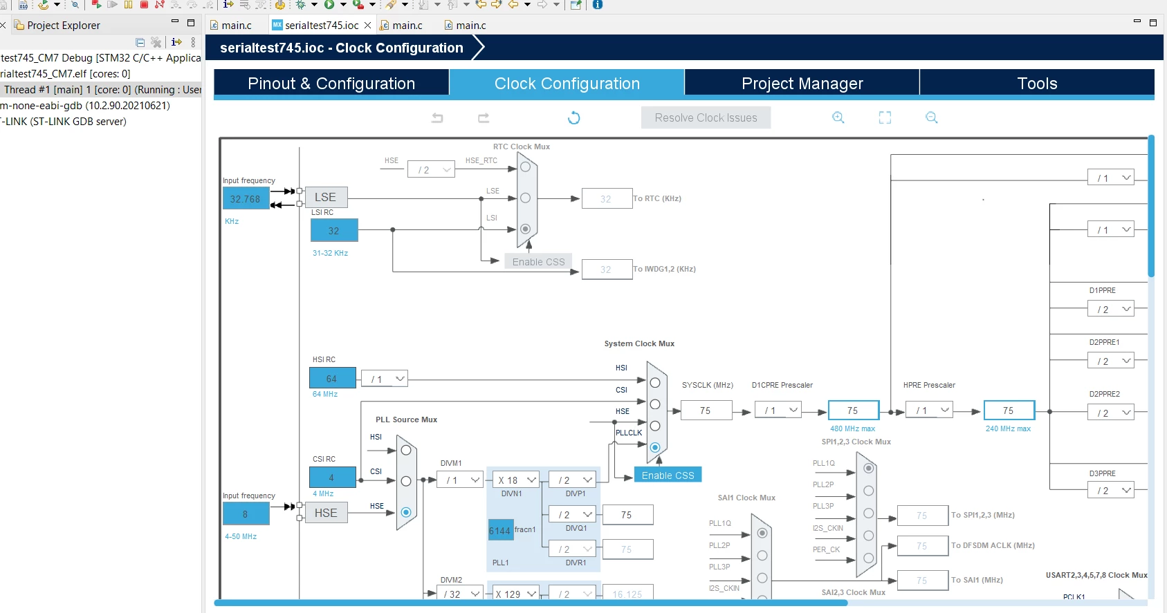

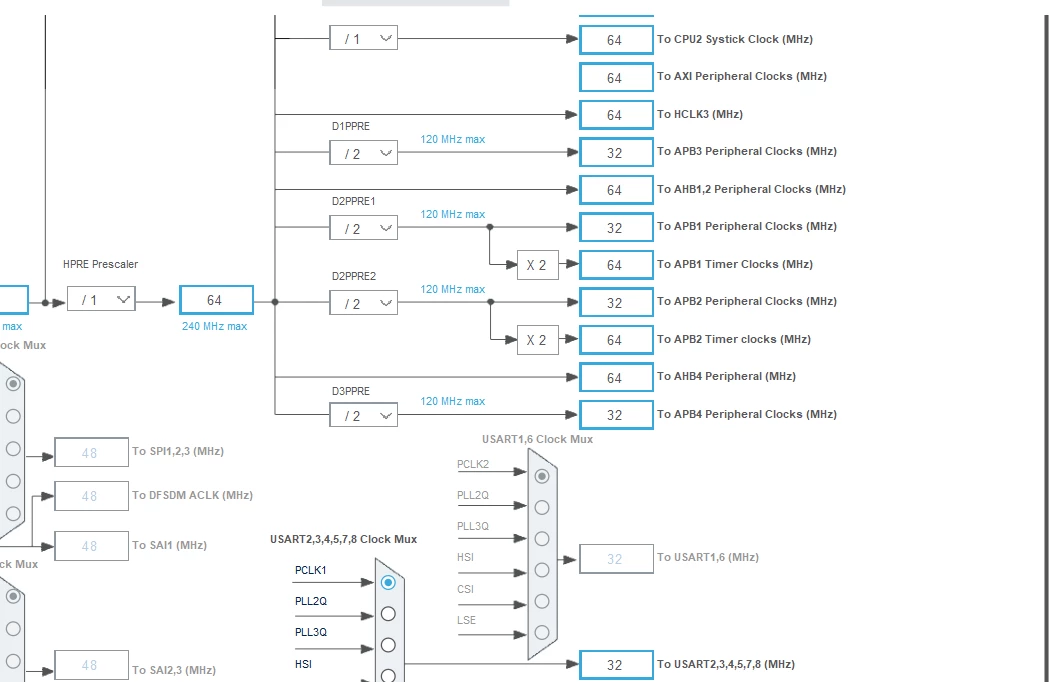

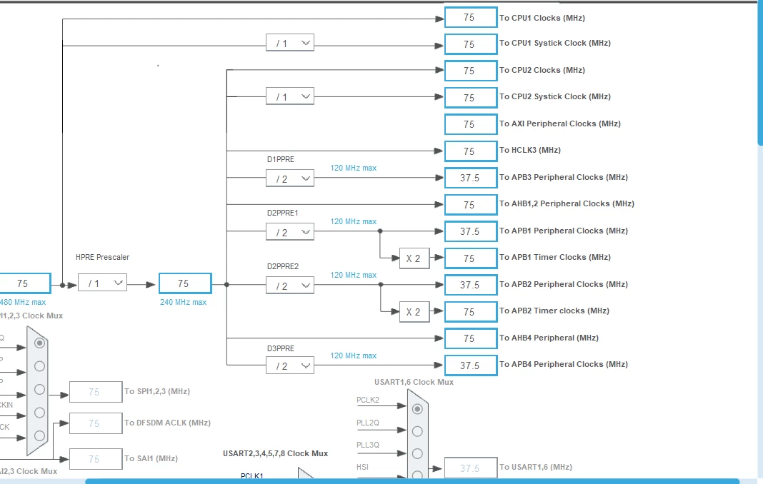

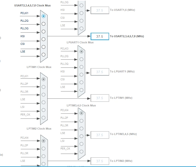

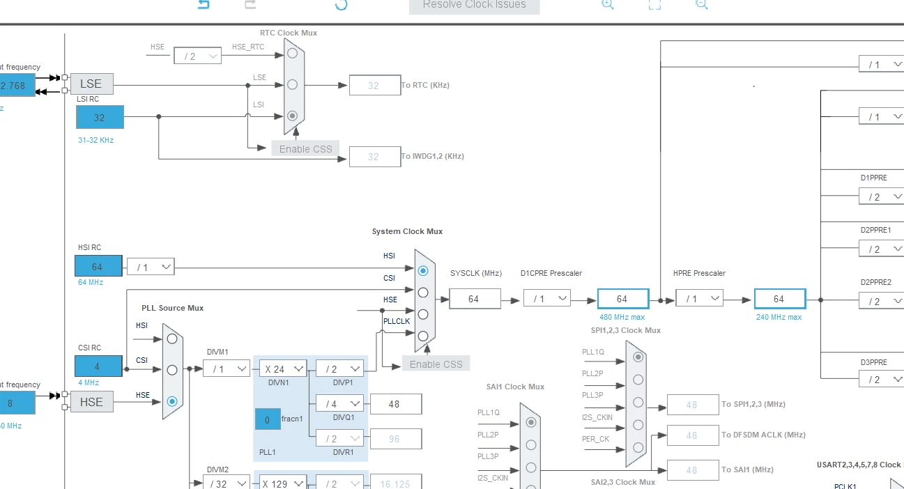

these are the clock setttinfg .but am doing wrong in clock side?

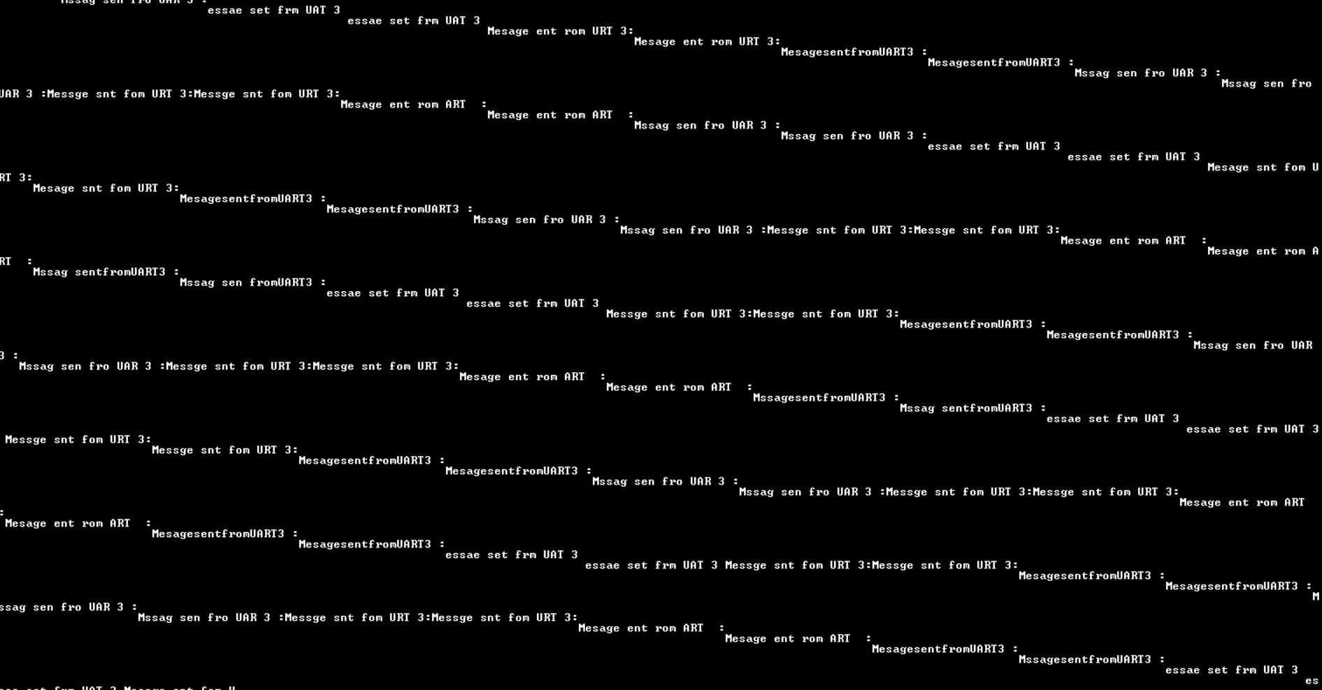

_legacyfs_online_stmicro_images_0693W00000biSsHQAU.pngthese are the output in which alphabats are missing
_legacyfs_online_stmicro_images_0693W00000biSp9QAE.pngthese are tera term settings

Probably not an issue with the code you're showing, but elsewhere.
W​hat chip and board are you using?
Which clock source? Is that properly calibrated? Which UART and pins, connected to what?
W​ould suggest sending 0x55 'U' data patterns constantly and inspecting signal timing on a scope.

Related https://community.st.com/s/question/0D53W00002DyX2XSAV/serial-port-not-work
Make sure to provide more detail and context.
Identify the board, chip and mode of connectivity.
Focus on the cause, not the symptoms. You're not looking in the right place.
Here perhaps the timing, whether MSI or HSI clock sources use the right calibration values, and how accurately they are clocking.
