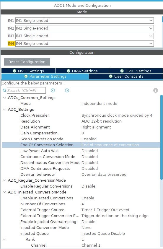

I was unable to configure ADC1 to measure a "4 channel sequence" and then generate an interrupt.
I am using the injected result registers to read the values in the ISR.
Adc_Value[0]= ADC1->JDR1;
Adc_Value[1]= ADC1->JDR2;
Adc_Value[2]= ADC1->JDR3;
Adc_Value[3]= ADC1->JDR4;
All values show zero!
 Can anyone provide an example code for reading injected results + interrupt?
Alternatively the DMA may be used, but when I try to use regular/non injected results via DMA, I am not able to generate an interrupt anymore!
 The sequence is triggered by TIM1 at every 15.8 uS.

Ok, should be possible;  on what G4 ?
+ can you attach your x.ioc ? (maybe as zip, if forum still not "allowed" ioc )

setup adc1 :
then try to start it:
 MX_ADC1_Init();
 MX_TIM1_Init();
 /* USER CODE BEGIN 2 */
 HAL_ADCEx_Calibration_Start(&hadc1);			// adc1 kalib.
 HAL_Delay(2);						// wait a little
 HAL_ADCEx_InjectedStart_IT(&hadc1);			// start adc for int mode
 HAL_TIM_Base_Start(&htim1);				// Trigger ADCs
 /* USER CODE END 2 */
-> then set breakpoint in adc int , check results in debug mode...

AScha.3
January 16, 2024
read again ... i edit -> start injected . :)
regular is set : disabled.
