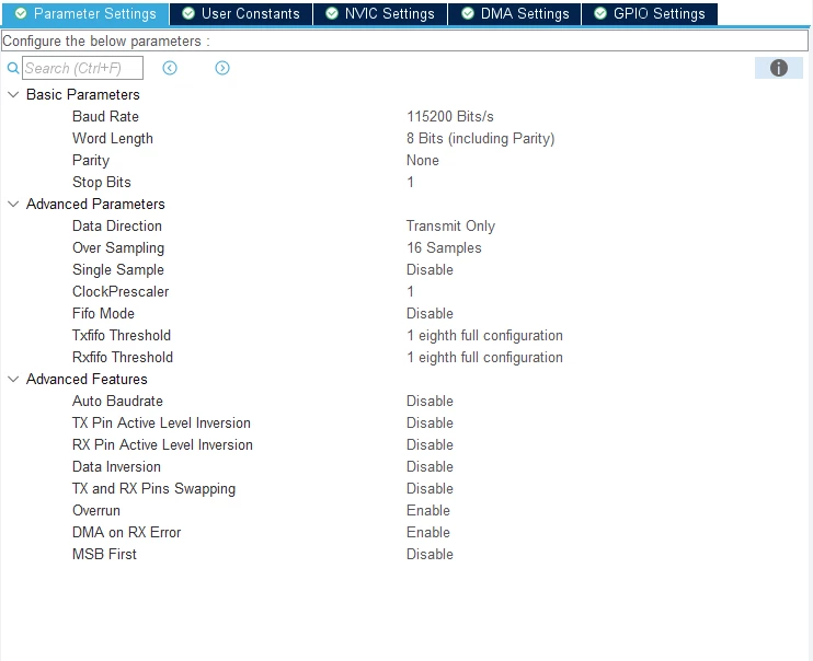

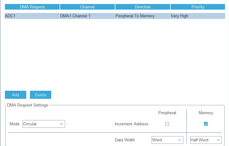

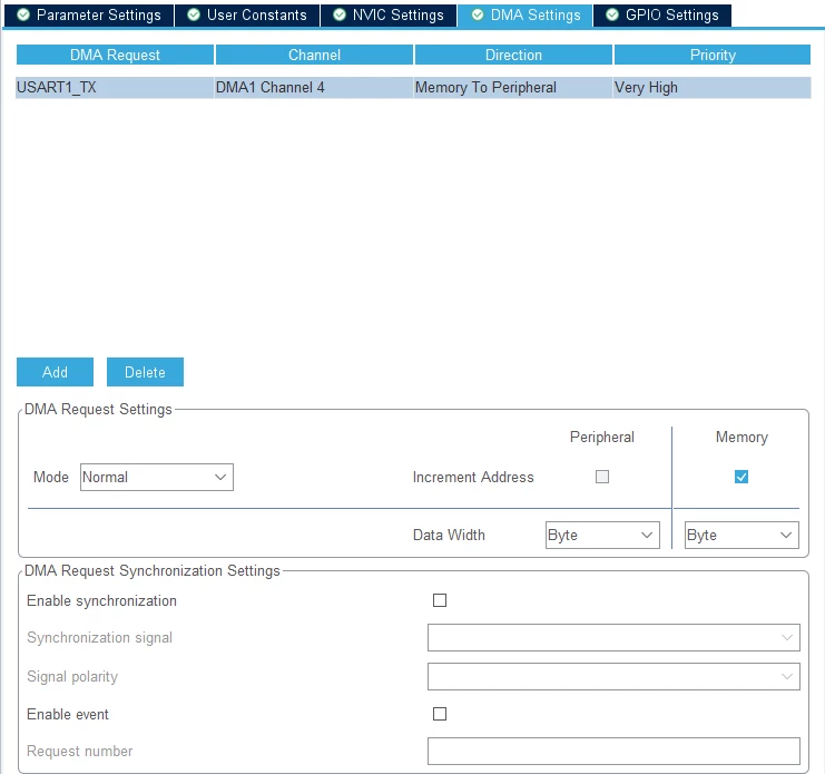

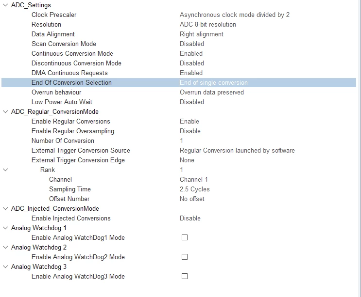

Hi, I am trying to sample ADC data with stm32l4s5 using b-l4s5-iot01a board. I enabled ADC, USART1 and DMA on both but I do not see anything on my serial terminal. I am trying to send it over st-link connection, I sent a sample text like "Hello" and it worked so usart configuration must be right other than DMA. I appreciate any advice.
This is my code:

 HAL_ADC_Start_DMA(&hadc1,(uint32_t*)&value_adc,1);
 HAL_UART_Transmit_DMA(&huart1, value_adc, sizeof(value_adc));

 /** Common config
 hadc1.Instance = ADC1;
 hadc1.Init.ClockPrescaler = ADC_CLOCK_ASYNC_DIV2;
 hadc1.Init.Resolution = ADC_RESOLUTION_8B;
 hadc1.Init.DataAlign = ADC_DATAALIGN_RIGHT;
 hadc1.Init.ScanConvMode = ADC_SCAN_DISABLE;
 hadc1.Init.EOCSelection = ADC_EOC_SINGLE_CONV;
 hadc1.Init.LowPowerAutoWait = DISABLE;
 hadc1.Init.ContinuousConvMode = ENABLE;
 hadc1.Init.NbrOfConversion = 1;
 hadc1.Init.DiscontinuousConvMode = DISABLE;
 hadc1.Init.ExternalTrigConv = ADC_SOFTWARE_START;
 hadc1.Init.ExternalTrigConvEdge = ADC_EXTERNALTRIGCONVEDGE_NONE;
 hadc1.Init.DMAContinuousRequests = ENABLE;
 hadc1.Init.Overrun = ADC_OVR_DATA_PRESERVED;
 hadc1.Init.OversamplingMode = DISABLE;
 if (HAL_ADC_Init(&hadc1) != HAL_OK)
 Error_Handler();
 /** Configure Regular Channel
 sConfig.Channel = ADC_CHANNEL_1;
 sConfig.Rank = ADC_REGULAR_RANK_1;
 sConfig.SamplingTime = ADC_SAMPLETIME_2CYCLES_5;
 sConfig.SingleDiff = ADC_SINGLE_ENDED;
 sConfig.OffsetNumber = ADC_OFFSET_NONE;
 sConfig.Offset = 0;
 if (HAL_ADC_ConfigChannel(&hadc1, &sConfig) != HAL_OK)
 Error_Handler();

static void MX_USART1_UART_Init(void)
 /* USER CODE BEGIN USART1_Init 0 */
 /* USER CODE END USART1_Init 0 */
 /* USER CODE BEGIN USART1_Init 1 */
 /* USER CODE END USART1_Init 1 */
 huart1.Instance = USART1;
 huart1.Init.BaudRate = 115200;
 huart1.Init.WordLength = UART_WORDLENGTH_8B;
 huart1.Init.StopBits = UART_STOPBITS_1;
 huart1.Init.Parity = UART_PARITY_NONE;
 huart1.Init.Mode = UART_MODE_TX;
 huart1.Init.HwFlowCtl = UART_HWCONTROL_NONE;
 huart1.Init.OverSampling = UART_OVERSAMPLING_16;
 huart1.Init.OneBitSampling = UART_ONE_BIT_SAMPLE_DISABLE;
 huart1.Init.ClockPrescaler = UART_PRESCALER_DIV1;
 huart1.AdvancedInit.AdvFeatureInit = UART_ADVFEATURE_NO_INIT;
 if (HAL_UART_Init(&huart1) != HAL_OK)
 Error_Handler();
 if (HAL_UARTEx_SetTxFifoThreshold(&huart1, UART_TXFIFO_THRESHOLD_1_8) != HAL_OK)
 Error_Handler();
 if (HAL_UARTEx_SetRxFifoThreshold(&huart1, UART_RXFIFO_THRESHOLD_1_8) != HAL_OK)
 Error_Handler();
 if (HAL_UARTEx_DisableFifoMode(&huart1) != HAL_OK)
 Error_Handler();

Stm325_0-1741722104329.pngStm325_1-1741722114771.pngStm325_2-1741722126571.pngAnd these are the ADC and USART configurations

Wait until the data is there before you send it. The ADC DMA operation happens asynchronously.
Your terminal program is probably set up to receive text, not raw data, and may silently ignore non-ASCII characters like 0.
Data is a uint16_t, not uint32_t.
Stm325Author
March 11, 2025
void HAL_ADC_ConvCpltCallback(ADC_HandleTypeDef* hadc)
 if (hadc->Instance == ADC1)
 char str_adc[10];
 sprintf(str_adc, "%lu\n", value_adc);
 HAL_UART_Transmit_DMA(&huart1, (uint8_t*)str_adc, strlen(str_adc));
I added this callback to convert it to string. Also the program looks like it is stuck at HAL_ADC_Start_DMA(&hadc1, &value_adc, 1); couldnt figure out why
March 17, 2025
Check if the overwrite flag is set as possible cause why ADC is stuck.  You may try setting overrun behavior to overwrite.
