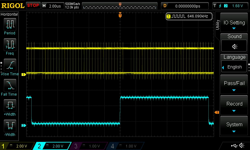

 (reordered) source file:

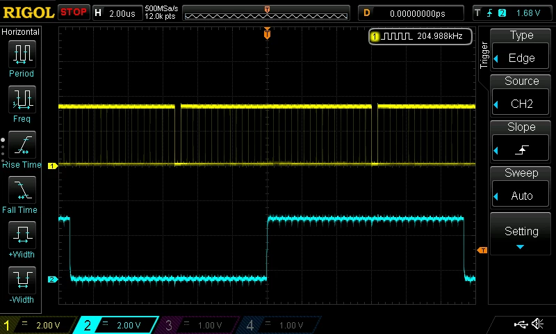

0693W00000Y8qLXQAZ.png but with filter :
0693W00000Y8qLcQAJ.pngobviously filter makes 32bit output -ok, but half-word shifted - wrong!
what happens here?? seems like upper and lower int16 are exchanged, after int_>float->int conversion. this is ...too much . last idea: i set DMA to transfer "half word" memory to "word" target - changed nothing, no exchange on 16bit int.

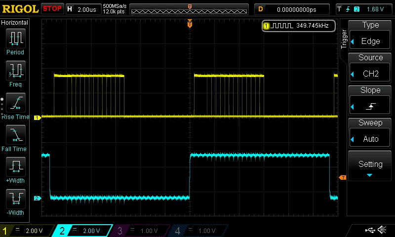

Oooo... never correct working with 32bit data. and even more: after some restarts sometimes (!) other timing...but also wrong. this is too much on wrong - i give up on this.
there is the SAI interface, can also work on I2S mode , so i try this.
hey, works (after some trouble, to get it working) with 16bit data AND with 32bit data also !!!!
and no endianess problem, just DMA transfers int32 to SAI (in slave mode), obviously correct:
