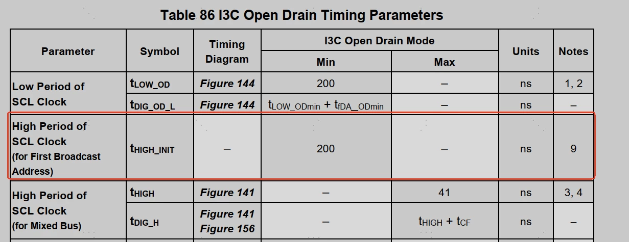

According to MIPI I3C Basic specification v1.1.1, page 366, Table 86 I3C Open Drain Timing Parameters
, note 9,The Controller uses this timing to send the first Broadcast Address after Bus initialization, in order to disable the I2C Spike Filter for applicable I3C Target Devices (see Section 5.1.2.2.2) (At least 200ns)

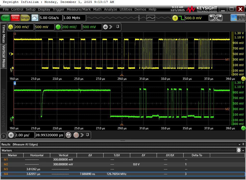

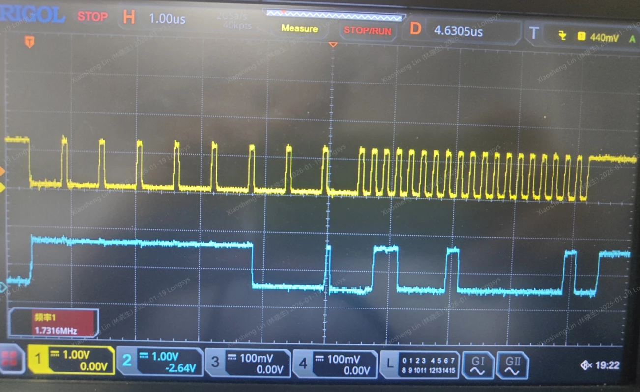

I have selected the "Bus Characteristics" as "Mixed I3C and I2C" and "I2C Duty Cycle" to be 50% in stm32cubeIDE's "Pinout & Configuration -> Connectivity -> I3C1", It generates the code with "hi3c1.Init.CtrlBusCharacteristic.SCLI2CHighDuration = 0x7c;", which seens fine. But when I run the function "HAL_I3C_Ctrl_TransmitCCC", I found the waveform is different, the SCL high duration is actually controlled by the parameter "SCLI3CHighDuration", shown below.
the SCL pulse is around 50ns and It is not responed by the DDR5 SPD Hub;
And the waveform of matherboard is shown below:
And I have not found any good alternative way to generate a start + broadcase Address in I2c timing to tigger it, to generate the waveform like motherboard;

Hello @LXS ,
No, on STM32H5 you cannot make HAL_I3C_Ctrl_TransmitCCC() send the 0x7E broadcast using the I²C timing (SCLI2CHighDuration).
CCC frames use the I3C timing (SCLI3CHighDuration, push‑pull) once the controller is in I3C mode.
To meet the MIPI requirement (≥200 ns SCL high in open‑drain) and wake up the DDR5 SPD:
  • Use GPIO bit‑banged I²C (or a normal I²C peripheral, if on the same pins) at power‑up to send:
    • START + address 0x7E (write) + ACK + STOP
      with I²C‑style open‑drain SCL high ≥ 200 ns.
  • Then reconfigure the pins to I3C and use HAL_I3C_Ctrl_TransmitCCC() for all subsequent I3C operations.
