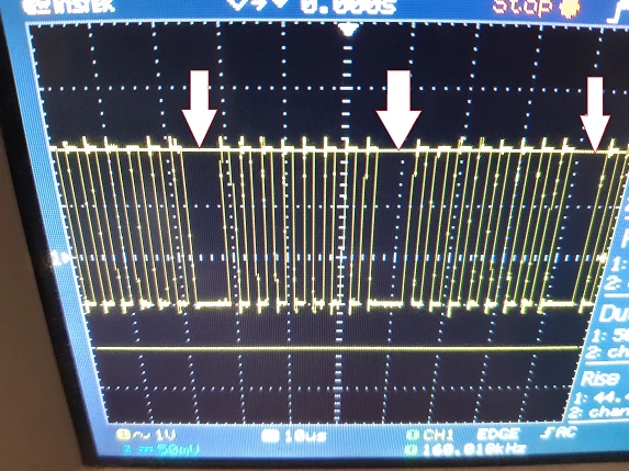

For communicating with a sensor I need to send 32 bits as a clock for my sensor. As you can see in the 8-bit data transmission an interruption occurs during sending 4 bytes which is unpleasant for my communication.
I wrote a Software SPI (bit-bang) with a timer but for low speed communication (even 200Khz) it makes my MCU slow (subroutine of time should be triggered each 2 us). How can I do for deleting the small interruption in Hardware SPI by using a software trick?

Do you mean that you need specifically for your sensor a perfect square wave at 2 usec period?
Because usually as the clock SCK signal is sent to the slave, it does not need to be "perfect"
Your code is interrupted by other (critical?) interrupt such as Systick, USB etc...
If you block interrupts, linked peripheral may malfunction when these interrupts are firering too late.
If this is not a problem in this specific application, and depending on the used STM32 (which you should at least give family name F1, L1, F4, L4, F7, etc...)
  1. Check what is the fastest SPI speed the sensor can accept
  2. Interrupt will take 24+ cycles
  3. Don't use Timer if the frequency is above 1 MHZ, use SW delay. say your core clock is 48 MHz, 1+ usec will be 48 nops.
  4. Then if the SPI complete transaction is short enough (<500 usec?) you might disable interrupts by wrapping the code like this:
 uint32_t tmp;
 tmp = __get_PRIMASK();
 __set_PRIMASK(tmp | 1);
 MyCodeWithInterruptsBlocked()
 __set_PRIMASK(tmp);

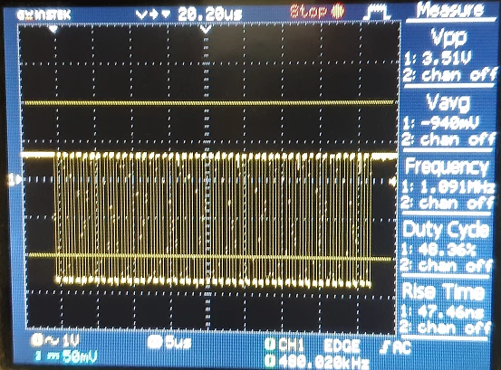

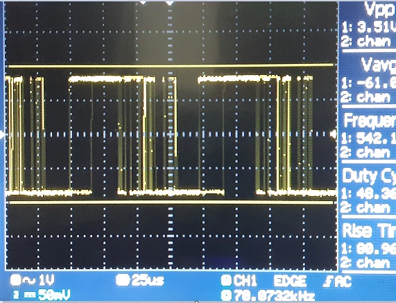

Actually I want to communicate with a 32bit sensor and my signal form is acceptable. Today I was successful to remove the little delay between bytes.( I send 16 bits with 16bit SPI mode) as you can see the attachment.
And here is my sensor output which is completely correct.
But I don't receive the right value of my sensor. I want to know this function SPI_I2S_ReceiveData returns two bytes from each 16bits transmission or byte by byte?
