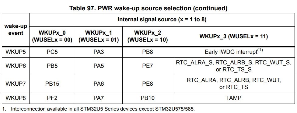

Hi everyone!
I have an u585 related question:
Can I configure RTC internal wakeup line other than PWR_WAKEUP_PIN7_HIGH_3 ?
In all u5xx examples used this line, but We have an external wakeup source on  PB.15.
I can't change it in CubeMX and I can't find any reference to change the RTC wakeup line, and if I use PWR_WAKEUP_PIN_HIGH_3, the RTC isn't weak up the CPU anymore.
On the stm32u5xx_hal_pwr.h defined more than one pin as RTC wakeup:
#define PWR_WAKEUP_PIN6_LOW_3 (PWR_WUCR1_WUPEN6 | PWR_WAKEUP6_POLARITY_LOW | PWR_WAKEUP6_SOURCE_SELECTION_3) /*!< RTC  : Wakeup pin 6 (low polarity) */
#define PWR_WAKEUP_PIN7_LOW_3 (PWR_WUCR1_WUPEN7 | PWR_WAKEUP7_POLARITY_LOW | PWR_WAKEUP7_SOURCE_SELECTION_3) /*!< RTC  : Wakeup pin 7 (low polarity) */
#define PWR_WAKEUP_PIN8_LOW_3 (PWR_WUCR1_WUPEN8 | PWR_WAKEUP8_POLARITY_LOW | PWR_WAKEUP8_SOURCE_SELECTION_3) /*!< RTC  : Wakeup pin 8 (low polarity) */

Hi @ccuebler,
Concerning you first question, as indicated in the Table 97 of RM0456 (or bellow), You cannot use both B15 and (RTC_ALRA, RTC_ALRB, RTC_WUT, or RTC_TS) as Wakeup source for WKUP7.
Attention : WKUP7 can only use RTC wakeup line if:
  • TZ = 0
  • TZ = 1 and RTC is non-secured

Hi @AlexisL !
Thank you for reply.
The wakeup problem:
So if the RTC is secured, it use the WKUP6 instead of WKUP7. I get it.
