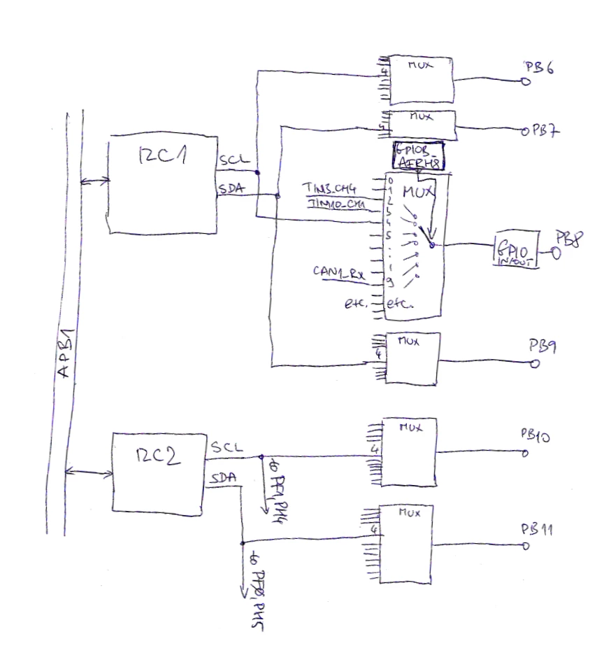

Hi folks,
I am a little confused by the AF selection on some pins in the case of using multiple I2C's.
I am bringing up a new board where board I2C1 and I2C2 are being used on an F4 micro.
I2C1 is on PB6 & PB7, I2C2 is on PB9 & PB10.
Looking at the MCU manual, it shows for the GPIO AF multiplexer: 'AF4 (I2C1..3, I2CFMP1)'
If I set PB9 to AF4, how is there a distinction between the pin functioning for I2C1 or I2C2?
#i2c #gpio #f4

waclawek.jan
March 16, 2018
Posted on March 16, 2018 at 23:40
apullin
apullinAuthor
March 17, 2018
Posted on March 17, 2018 at 06:23
Thanks for the diagram. I don't think this exactly captured the point I was confused about, but nearly: if there was a wire from the I2C2_SDA node up to AF9 of PB9, that would reveal what I was missing.

The pin routing on individual pins is clearly shown in the Data Sheet tables. AF Mux on the pin is a 16-to-1 routing, I2C1 presumably has NO routing to PB9, where AF4 is connected to an I2C2 SDA node internally.
Each pin has its own MUX, each mux connects to different NODES.

Aha.
So my confusion was partly from using an old version of the ST libraries, which ,has a section of the gpio header with:
♯ define
GPIO_AF_I2C1
uint8_t
0x04
/* I2C1 Alternate Function mapping */
♯ define
GPIO_AF_I2C2
uint8_t
0x04
/* I2C2 Alternate Function mapping */
♯ define
GPIO_AF_I2C3
uint8_t
0x04
/* I2C3 Alternate Function mapping */
That confused me, so looking at the manual, I saw that indeed AF4 was allocated for I2C1..3. But what I missed was that AF9 is also a candidate for I2C1..3 connections.
Now that I look into the actual pin function matrix in the device datasheet per your recommendation, I do see that for PB9, AF4 = I2C1_SDA, but AF9 = I2C2_SDA , for PB9.

So I just had to be cognizant of heterogenous ,mappings for the pin muxes, and make the right choices for my project using the old ST libraries.
Generating a minimum working example using CubeMX, it does correctly select the pin-specific AF value:
