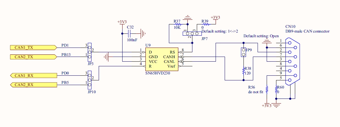

Hello everyone,
I am looking for a board with a STM32F4 or any other microcontroller (STM32) with 2 CAN. The main issue I am facing, is finding a developpement board where the 2 CAN inputs/outputs are available (for example in the STM32F4 discovery board, one is connected to the USB, which doesn't suit me).
So if anyone knows a board that could fit my needs !
In advance, thanks !

STM3240G-EVAL and STM3241G-EVAL boards have two CAN interfaces (but only one transceiver).
All CAN signals are available on external headers however:

That would work exactly the same way as if I had two transceivers, right ?
For you to understant a bit more, I am trying to basically create a link between two CAN network working at a different rate. These boards could work for this application, right ?
Thanks !

EVAL boards are pretty expensive but the only ones that have onboard transceiver and DB9 connector.
As a much cheaper alternative you may want to go with a
http://www.st.com/content/st_com/en/products/evaluation-tools/product-evaluation-tools/mcu-eval-tools/stm32-mcu-eval-tools/stm32-mcu-nucleo/nucleo-f446re.html
 and mount external transceivers such as
https://www.amazon.com/SN65HVD230-CAN-Board-Communication-Development/dp/B00KM6XMXO/ref=sr_1_2?ie=UTF8&qid=1528806936&sr=8-2&keywords=SN65HVD230
 (just picked up the first Amazon choice, double check if suits your needs).
