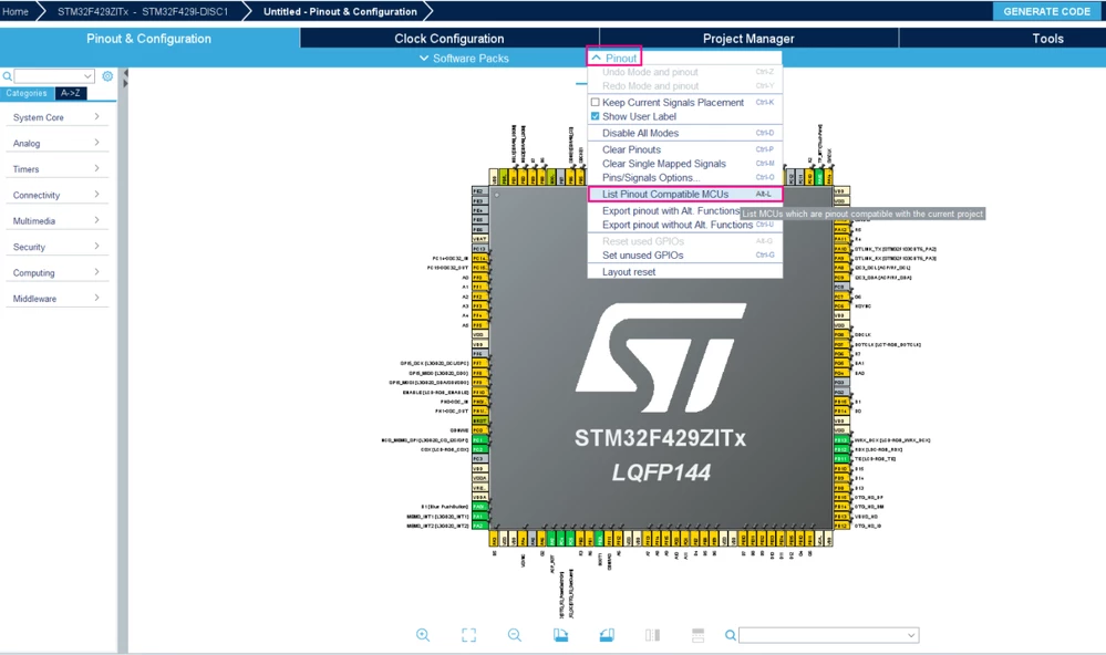

I'm looking for a comparison between STM32F2/F4 and STM32H5 to facilitate the migration: timers, important information.
Thank you in advance.
Best answer by STTwo-32
Hello @andreaswollmann77
The best document I can suggest you is the AN5688. For pin compatibility, you can create a project based on your MCU on CubeMX and find all pinout compatible MCUs following this picture :
Best Regards.
Best Regards.

Is there also an AN for STM32F2xx to STM32H5 migration?
STTwo-32
March 16, 2025
unfortunately, there is not such a document. You should do the migration based on the datasheets and reference manuals of the MCUs.
