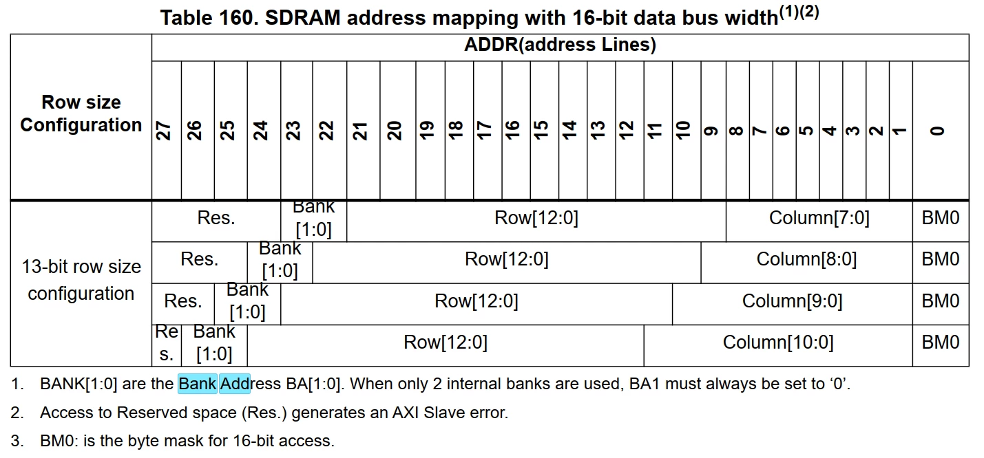

I've tried to see if I can get away with using just one bank address pin for a 4-bank SDRAM (IS42/45S16160J). My understanding is that this would half the addressable memory, as I could only access two banks instead of four.
In the STM32H7 user manual I find the following table that matches my SDRAM:
This indicates to me that the banks are laid out as contiguous memory blocks.
However, when I try this by configuring BA1 as GPIO output and set it to either low or high, I find that I can access the whole memory but only using 1- or 2-byte access, while 4-byte access are not working anymore (atleast not on 0xd0000000). It also doesn't seem to matter how I init the InternalBankNumber field for the FMC HAL API, both FMC_SDRAM_INTERN_BANKS_NUM_2 and FMC_SDRAM_INTERN_BANKS_NUM_4 seem to lead to the same result.
Can anyone explain what's going on here? Am I missing something?
Bonus question: How are 4-byte accesses handled in general over a 16-bit bus? Does the FMC send two READ/WRITE commands? In the code below a burst length of 1 is used.
Below is my init and test code.
