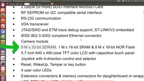

    MT48LC2M32B2 is 2 Meg x 32 (512K x 32 x 4 banks)
    but my board is 8 M x 32-bit SDRAM (page 6 from DM00093454.pdf)
    where is different?

    UM1668 on the schematics states MT48LC4M32B2 which is 1 Meg x 32 x 4 Banks.
    What a mess.

    It seems that is a typo error in Eval board user Spec (DM00093454.pdf), the correct information should be 8Mbytes SDRAM, 2Meg x 32-Bits.

    Posted on October 16, 2014 at 13:40
    With
    my own
    eyes
    I
    saw
    the
    writing
    on the
    board
    (IS42S32800G =8M x 32bit=2Meg฀ x฀ 32฀ bit฀ x฀ 4฀Banks)
    but page 45 on DM00093454.pdf is for MT48LC4M32B2B5-7.
    now what can we do?

    The only difference between the 2Mx32 and 8Mx32 chip (except the timing, a.k.a. ''latencies'', of course) is the addressing: while MT48LC2M32B2 uses A10:A0/A7:A0 for row/column addressing, IS42S32800G uses A11:A0/A8:A0.
    This should be reflected in the programming of FMC, but I am no expert on that (a quick glance into RM0090: NC and NR fields in FMC_SDCRx register should do the trick).
