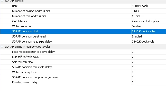

static void MX_FMC_Init(void) {
	FMC_SDRAM_TimingTypeDef SdramTiming;
	/** Perform the SDRAM1 memory initialization sequence */
	hsdram1.Instance = FMC_SDRAM_DEVICE;
	/* hsdram1.Init */
	hsdram1.Init.SDBank =			FMC_SDRAM_BANK1;
	hsdram1.Init.ColumnBitsNumber =		FMC_SDRAM_COLUMN_BITS_NUM_9;
	hsdram1.Init.RowBitsNumber =		FMC_SDRAM_ROW_BITS_NUM_12;
	hsdram1.Init.MemoryDataWidth =		FMC_SDRAM_MEM_BUS_WIDTH_32;
	hsdram1.Init.InternalBankNumber =	FMC_SDRAM_INTERN_BANKS_NUM_4;
	hsdram1.Init.CASLatency =		FMC_SDRAM_CAS_LATENCY_2;
	hsdram1.Init.WriteProtection =		FMC_SDRAM_WRITE_PROTECTION_DISABLE;
	hsdram1.Init.SDClockPeriod =		FMC_SDRAM_CLOCK_PERIOD_2;
	hsdram1.Init.ReadBurst =		MC_SDRAM_RBURST_ENABLE;
	hsdram1.Init.ReadPipeDelay =		FMC_SDRAM_RPIPE_DELAY_0;
	/* SdramTiming */
	SdramTiming.LoadToActiveDelay =		2;
	SdramTiming.ExitSelfRefreshDelay =	7;
	SdramTiming.SelfRefreshTime =		7;
	SdramTiming.RowCycleDelay =		6
	SdramTiming.WriteRecoveryTime =		4;
	SdramTiming.RPDelay =			3;
	SdramTiming.RCDDelay =			3;
	if (HAL_SDRAM_Init(&hsdram1, &SdramTiming) != HAL_OK) {
		_Error_Handler(__FILE__, __LINE__);

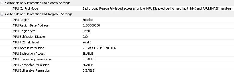

void MPU_Config(void) {
	MPU_Region_InitTypeDef MPU_InitStruct;
	/* Disables the MPU */
	HAL_MPU_Disable();
	/**Initializes and configures the Region and the memory to be protected */
	MPU_InitStruct.Enable =			MPU_REGION_ENABLE;
	MPU_InitStruct.Number =			MPU_REGION_NUMBER0;
	MPU_InitStruct.BaseAddress =		0xD0000000;
	MPU_InitStruct.Size =			MPU_REGION_SIZE_32MB;
	MPU_InitStruct.SubRegionDisable =	0x0;
	MPU_InitStruct.TypeExtField =		MPU_TEX_LEVEL0;
	MPU_InitStruct.AccessPermission =	MPU_REGION_FULL_ACCESS;
	MPU_InitStruct.DisableExec =		MPU_INSTRUCTION_ACCESS_ENABLE;
	MPU_InitStruct.IsShareable =		MPU_ACCESS_NOT_SHAREABLE;
	MPU_InitStruct.IsCacheable =		MPU_ACCESS_CACHEABLE;
	MPU_InitStruct.IsBufferable =		MPU_ACCESS_NOT_BUFFERABLE;
	HAL_MPU_ConfigRegion(&MPU_InitStruct);
	/* Enables the MPU */
	HAL_MPU_Enable(MPU_PRIVILEGED_DEFAULT);

Tesla DeLorean
Guru
August 25, 2021
Isn't BANK1 at 0xC0000000 ?
