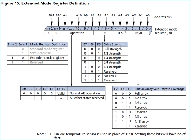

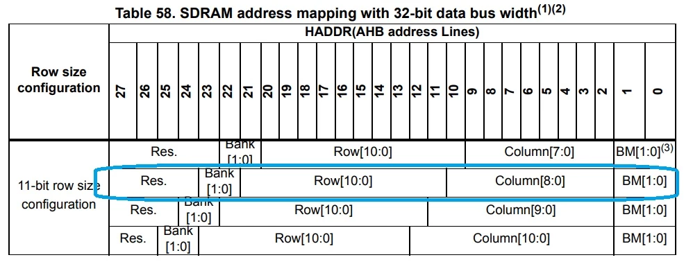

I am using an STM32F769NI with a MT48H16M32LFB5-6 SDRAM chip, everything works fine. we are looking to set the drive strength to 1/4, 1/2 and full to evaluate the effect on EMC testing. From what I read in the programming manual, it states to perform a dummy read access while BA1=1 and BA=0 in order to select the extended mode register instead of the load mode register and then program the needed value. When I perform the dummy read I receive a hard fault. If anyone can help explain what needs to be done to program the extended mode registers it would be greatly appreciated.

Tesla DeLoreanBest answer
Guru
Jun 13, 2019 10:49 PM UTC
Hard Faults because you're beyond the scope of memory
0xC0C00000 would set BA0/BA1=High
0xC0800000 woud set BA0=Low, BA1=High
