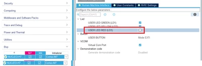

Hi folks,
I have SDMMC1 working on CM7 on my H755 Nucleo. Now I want to migrate FAT-FS and the uSD to CM4, in which case I think I should switch to the SDMMC2 peripheral since it's in D2 domain along with CM4.
I have a some questions about this and would be grateful for advice.
Firstly, am I right in believing that although the CM4 core can access SDMMC1 via the D2-to-D1 AHB, this is going to be slower than using SDMMC2, and is any such speed penalty significant?
Secondly, assuming that I should indeed use SDMMC2, I can't do this because PB14 is reserved for LD3 whilst this is needed for D3 on SDMMC2. I see from the data sheet that I can remove R75 in order to free-up PB14, but I wonder how CubeIDE knows that I've done this, since I've tried resetting the pin (in CubeIDE) and although it let's me do this and then generates code using SDMMC2, the next time I load the .ioc I see that SDMMC2 is showing as not available and has been unchecked.
Finally, why can't I use SDMMC2 in 1-bit mode, since PB14 is used for D3: which appears to be a good choice that allows people to retain LD3 if they only need 1-bit SDIO mode for SDMMC2. Might this be a bug in CubeIDE?
Thank you

Hello and sorry for the late answer.
I'm probably not going to answer all the questions but I will try to answer some of them:
On STM32H7 product, SDMMC1 and SDMMC2 are masters (unlike on other products) and the performance doesn't depend on the core access but to the memory the SDMMC is accessing. And you can use CM4 with SDMMC1 and CM7 with SDMMC2 as they are not tightly coupled.
Look for example at this discussion the OP has succeeded to make the SDcard working with CM4+SDMMC1.
For CubeIDE/CubeMx, I think you've started your project based on the board and you activated by default the BSP which leads to set PB14 as LD3.
So in "Bsp" tab, uncheck LD3 option:
Hope that answers your questions.
