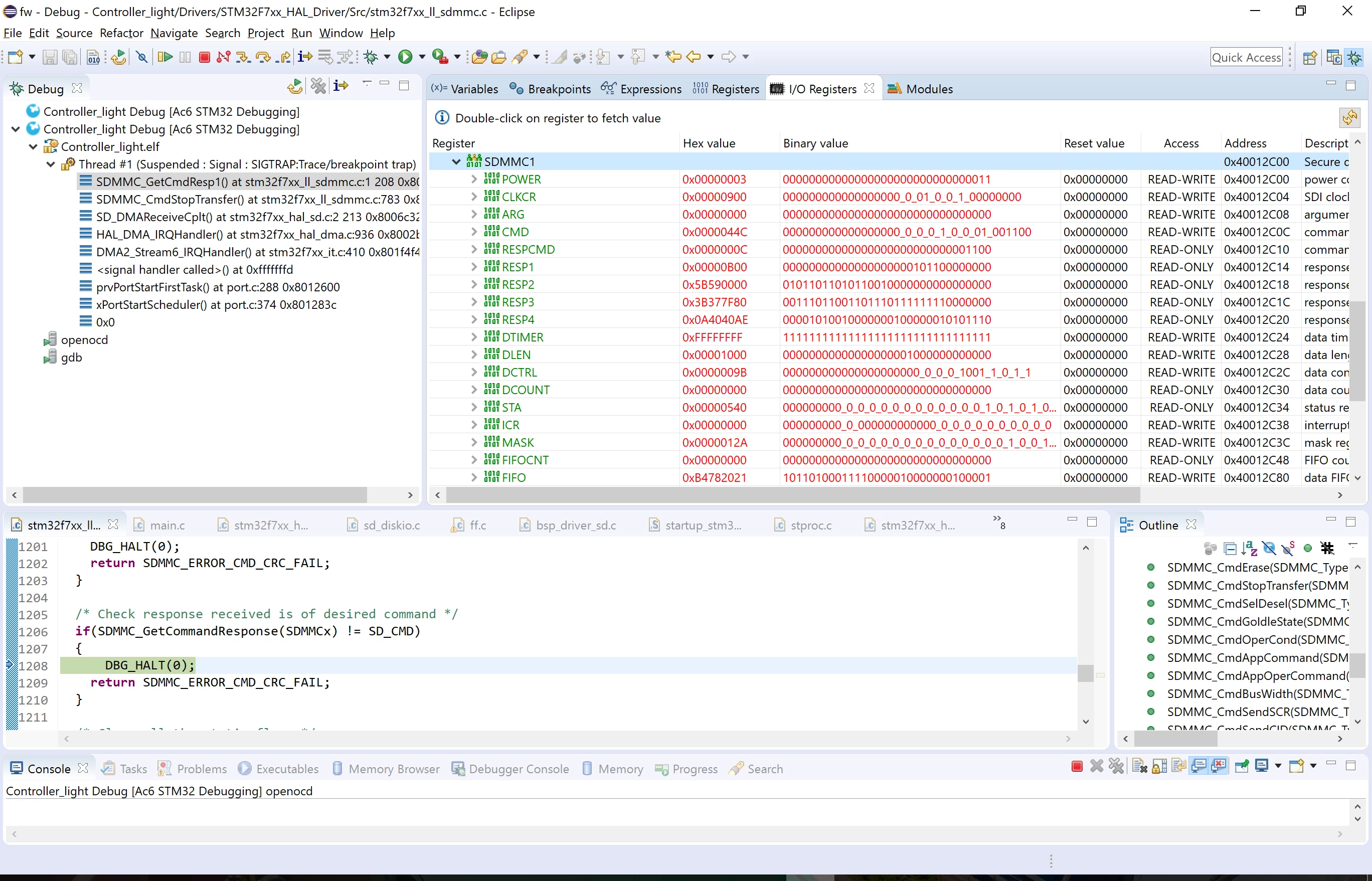

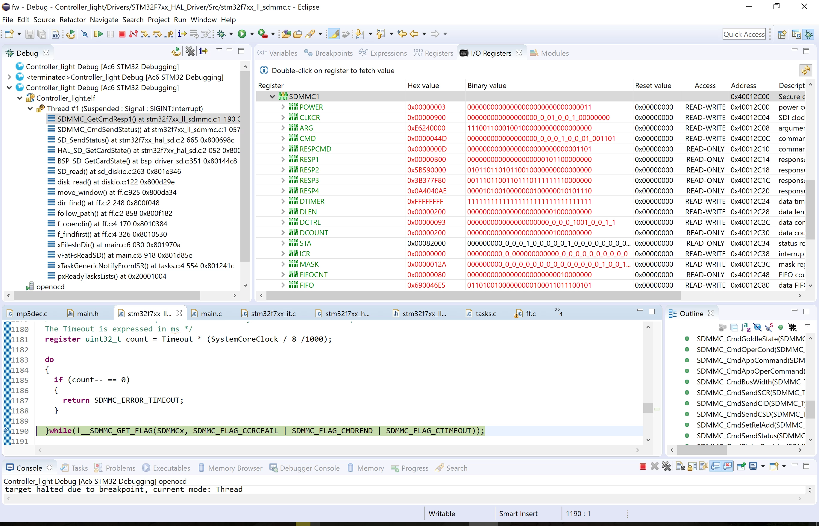

My app based on STM32CubeF7 Firmware Package V1.11.0 / 23-February-2018 gets stuck in SDMMC_GetCmdResp1() during directory scan randomly - it can stuck just after switching on or after 2 minutes of working. I can do nothing with sd until I switch off and switch on SD power.
I found a ''solution'' by adding delay:

UPDATE: I found that in some cases before timeout I get SDMMC_ERROR_CMD_CRC_FAIL
