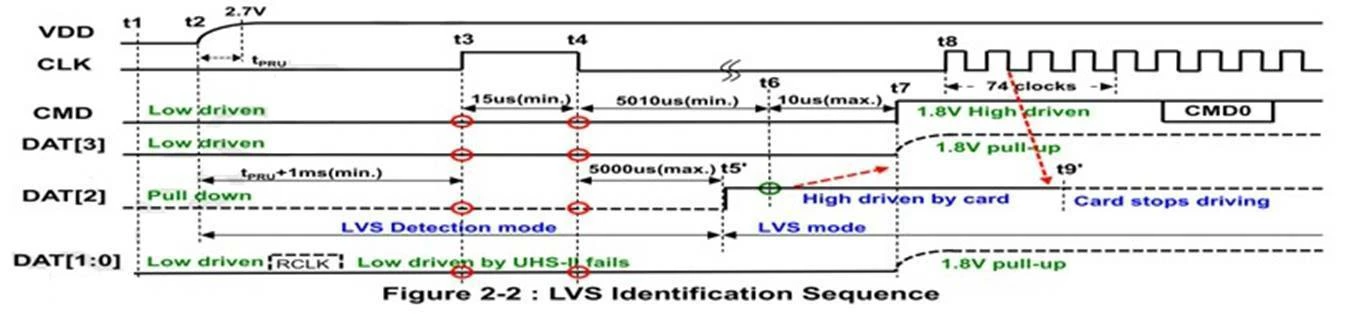

Yes, no SD card runs from the beginning with 1.8V. An identification sequence has been defined by the SD Association to enable LVS mode. Below is the description of the flow by the SD Association :
The host interface also needs to pull CLK high for 15 microseconds, followed by DATA2, and so forth, as specified.
At the end the SD card can run with 1V8 but the signals cannot initialize on 1V8.

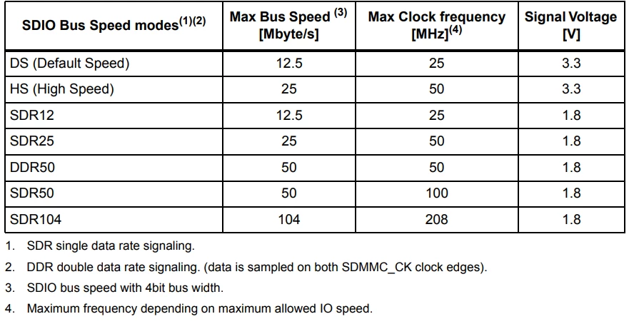

Look in rm of your cpu, sdmmc possible speed is written there . :)
Afaik all STM cpus need external driver for working on 1,8V on any of this hi-speed modes;
many of the more recent cpus can do this,
see here from H7A3 rm :
Without separate driver/level shifter only 3,3v modes possible.
