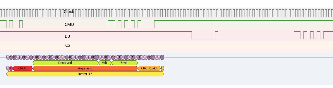

I'm working with STM32L476 trying to get a microSD card to communicate. Initially I'm sure I was getting a response, but now when I send CMD8 the chip does not see a respons from the card (SD_CMD_RSP_TIMEOUT). Even though the signal is present on D0.
Here is clock setup, initially clock runs at ~300kHz for setup.

Clock and CMD pins are correct for sure, as its sending data to the card and the card is responding. However, the code or chip isn't seeing the response come in. I've tried setting PC8 (SDMMC1_D0) as an output and toggling, and that shows up on the logic analyzer, so its not as if the pin is not connected to the SD card. Attached is image of logic analyzer output:
  • CMD8 is sent
  • Reply looks correct to me (R7, voltage and check pattern 101010 is there)
  • However, SD_CmdResp7Error thinks it times out
If I look at the SDMMC1 registers, the CTIMEOUT register is active. Which will occur after 64 SD clock cyles of no response. But clearly the response is there (about 15 clock cycles), so I am not sure what I am missing.
Checked errata and there is a mention of CRCFAIL and WAITRESP when sending a command without a response. So I don't see those being relevant. Thanks #sdmmc

Edit: very simple mistake by me was cause of problem. I was getting a response on D0 and thinking that everything was setup correctly. But its because I was entering SPI mode which is completely different than SD mode (SD mode the response is on the same CMD pin, SPI mode the response is on D3 pin). See page 14 here: http://users.ece.utexas.edu/~valvano/EE345M/SD_Physical_Layer_Spec.pdf
- No response to CMD0 is expected (this is right in HAL).
- If SPI mode is accidentally entered, unplug the card to reset it, or it will be stuck in that mode. Just tie/pull that pin high if you are using a microSD module with a ''CS'' pin, as we don't need it in 1-bit SD mode.
- Some SD cards will require additional delay after sdmmc clock is started. I believe this is in the spec, HAL does not wait long enough. Add a 1ms delay after __HAL_SD_SDMMC_ENABLE(hsd);
- The first R1 response I got to CMD55 was COM_CRC_ERROR. But its gone away now (crc info here http://wiki.seabright.co.nz/wiki/SdCardProtocol.html). If I see it again I will investigate.
