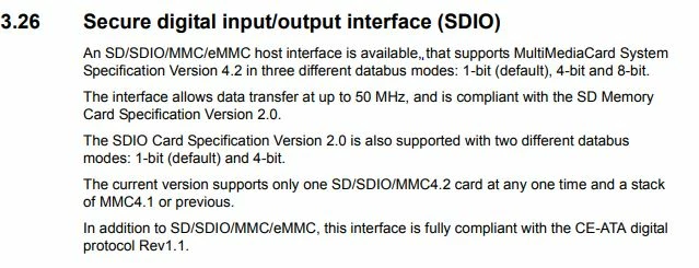

Hello @jjpark78_superman​ and welcome to the STM32 Community =)
STM32F4 supports the SD version v2.0 according to the SDIO specification, with max capacity 32 GB.
The data transfer for SDIO is up to 50 MHz for the 8 bit mode.
0693W00000AMDDcQAP.jpgI advise you to refer to the RM0383 and STM32F411xC datasheet to check the SDIO main features and the "Dynamic characteristics: SD / MMC characteristics" table.
Hope my answer helped you!
