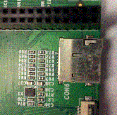

    Depends on the size of the read in question. I've got SDHC cards reading at 10.6 MBps using nominal clocks, and 15.8 MBps with aggressive clocks.
    Sandisk Extreme MicroSD Card, 32 MB read as 32 KB blocks. STM32F4-Discovery + STM32F4-DIS-BB
    If you're read small, or oddly aligned bits of data it's likely to be slow and awkward.

    Ok, from other threads I've concluded that you're already using code I posted, and you've got this wired up oddly, I've written several times on the forum, and in posting notes how to wire these things up.
    I've illustrated, to my own satisfaction, that a 4-bit SDIO bus clocked at 24 MHz, using DMA, can achieve at least 10 MBps with large multi-sector transfers.
    So let's focus on what you're doing, and draw out from you something about your software, hardware and testing methods...
    How do you have the interface wired up? Provide a schematic, details about the socket, and length of cabling.
    What kind of card(s) are you using? Form-factor, size, speed, rating etc.
    What speed are you clocking the interface?
    Is your lack of speed observable at the SDIO code interface, ie below FatFs?
    How are you benchmarking the speed?
    Do you have a large file written to the media, and can you validate it's content as read by the STM32?
    Are you using DMA? Are you using 4-bit mode? What are your processor and bus clocks?
    Are you using SDIO and/or DMA interrupts?

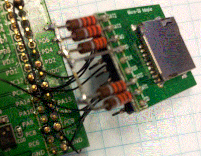

    i'm beginner with sd card and i use this your project at this link
    https://my.st.com/public/STe2ecommunities/mcu/Lists/cortex_mx_stm32/DispForm.aspx?ID=25551&RootFolder=https%3a//my.st.com/public/STe2ecommunities/mcu/Lists/cortex_mx_stm32/SDIO%20and%20SD%20fat%20access%20example
    -i use stm32f4 discovery. and i clocked cpu at 42MHZ AND 24MHZ for SDIO .
    -i just want READING 2MB/SEC AT 42 MHZ . AND READING about 8MB AT 168MHZ. this is my dream
    - i use your project and read 150KB FILE IN ONE SECOND with 16KB BUFFER. with 42MHZ CPU AND 24MHZ SDIO
    - sorry i can't answer all your question because i'm beginner and i don't know if your project using dma or what .
    https://my.st.com/public/STe2ecommunities/mcu/Lists/cortex_mx_stm32/DispForm.aspx?ID=23354&RootFolder=https%3a//my.st.com/public/STe2ecommunities/mcu/Lists/cortex_mx_stm32/ST32f4discovery%2bsdcard%2bfatfs%20problem
    i use 2gb micro sd and it's reading speed is 5MB/SECOND tested from my computer.
    my cabel is 10CM with sd adapter like this with 47k pullup resistor.
    http://3.bp.blogspot.com/-YRk9TlY-nd0/USNnZXgEJeI/AAAAAAAADsI/e8PyI58nWjA/s320/DSCF14JPG
    thank you very much

    Ok, I don't think running the CPU at 42 MHz and the SDIOCLK at 48 MHz (24 MHz @ card) is desirable. It causes a clock precedence inversion. The documents suggest it can tolerate an APB2 as low as 9 MHz, but doesn't discuss the AHB/CPU clocks. Not saying this is the issue, but it's where I'd start.
    You perhaps want to either clock the CPU >= 48 MHz, or get SDIOCLK (PLL_Q tap) <= 42 MHz
    You have the wires soldered to a Full size SD Card? or was there something else at the blog spot you wanted to point at? You mentioned MicroSD, and all my analysis/diagrams are for MicroSD.
    Observations:
    10 CM (100mm) is a LONG cable
    the 47K pull-up need to be at, or proximate to the card interface.
    I'd want to see equal lengths, closer to 30-40 mm
    Have you considered using something like the
    http://www.newark.com/stmicroelectronics/stm32f4dis-bb/add-on-brd-base-brd-for-stm32f4/dp/47W1731

    Burn the attached .HEX with the ST-Link Utilities, and then use the SWV option at 42 MHz. I suppressed the SD Card Detect pin based on previous forum discussions.
    FatFs Testing for asr.ahmed STM32 Forum
    ---- 600 /LOG.TXT
    ---- 32768000 /SPEEDTST.BIN
    ---- 0 /DIR.TXT
    Done
    STM32 1024 KB FLASH, 192 KB RAM, 003A003D-32314717-32303538 UNIQUE
    SYS:42000000, H:42000000, P1:42000000, P2:42000000
    CPU:42000000, SDIO:48000000,24000000
    CRC32 317BA605 Memory Image
    32768000 Bytes, 826783010 Cycles
    1.664592 MBps Write (FatFs)
    CRC32 317BA605 SPEEDTST.BIN
    32768000 Bytes, 827280041 Cycles
    1.663591 MBps Write (FatFs)
    32768000 Bytes, 142024349 Cycles
    9.690282 MBps Read (FatFs)
    32768000 Bytes, 142018461 Cycles
    9.690684 MBps Read (FatFs)
    Done

    i try your hex file and it's like magic i read 9.5MB/SEC AT 42MHZ ONLY !!!. how you make this ? you are Genius 0.o plaese tell me how you do it pleas. and thank you alot for helping me i love you. you helping me alot from start .
