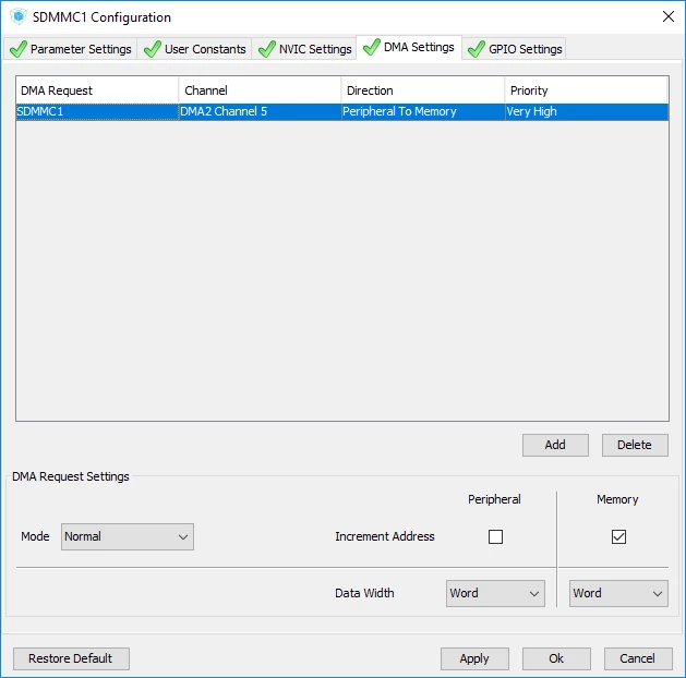

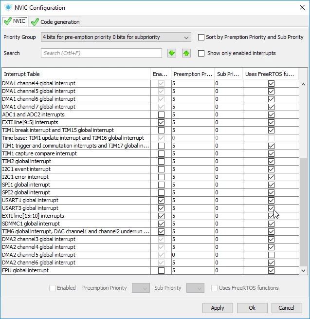

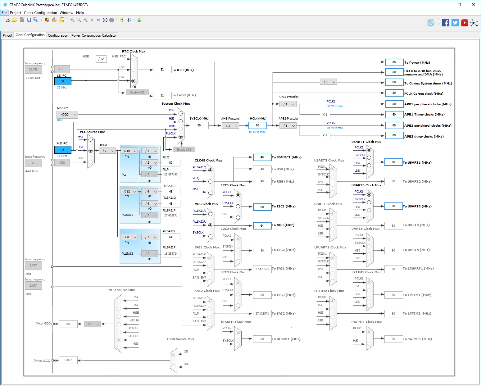

Dear friends,
I have an issue with uSD reading and writing in DMA mode (How ever I am able to read and write data on SD card when dma template is off). I used CubeMX to configure
but it did not work for me ''out of the box''.
My CubeMX version is 4.25.0 and L4 MCU package is 1.11.0.
Could you point out what I am doing wrong in configuration or in my code or if it is CubeMX issue, could you please advice me how to solve it?
I found some topics related to SDIO and DMA configuration and tried to implement them :
https://community.st.com/0D50X00009XkVtKSAV
https://community.st.com/0D50X00009Xkf5gSAB
https://community.st.com/0D50X00009XkYIGSA3
Below you find screen shots with my settings and my SW4STM32 project including CubeMX file.
My MCU setup:
My CubeMX configuration:
1) Clock
2)Clock factor
3)NVIC
4)DMA
5)Pin configuration
6)FatFS (sector size)
7)DMA template enabled
#fatfs-sdio #stm32l476 #sdio-dma #sd-card #sdio+dma+fatfs #stm32l4-sdio

Finally, I get it worked with CubeMX 4.25 and MCU pack 1.0!
The list of issues:
1) Missing line in time configuration
RCC_OscInitStruct.PLL.PLLM = 1; //Missed line
2) Change according to

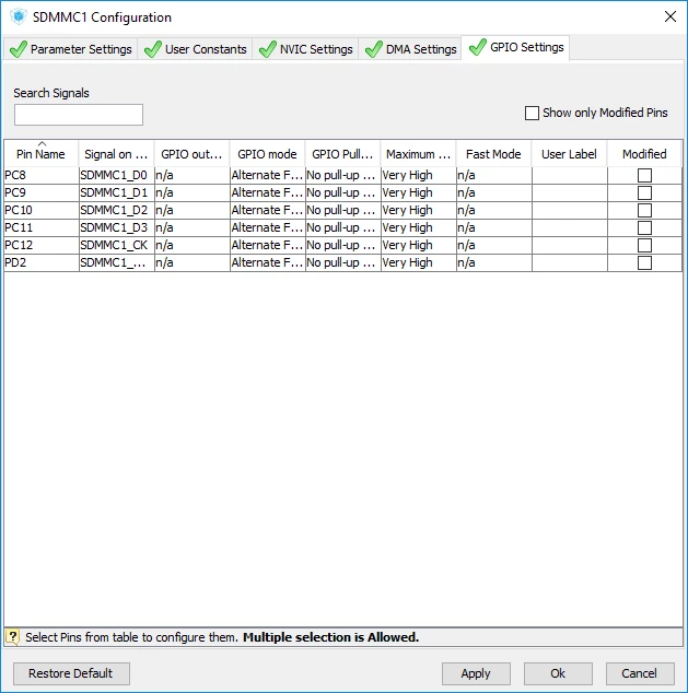

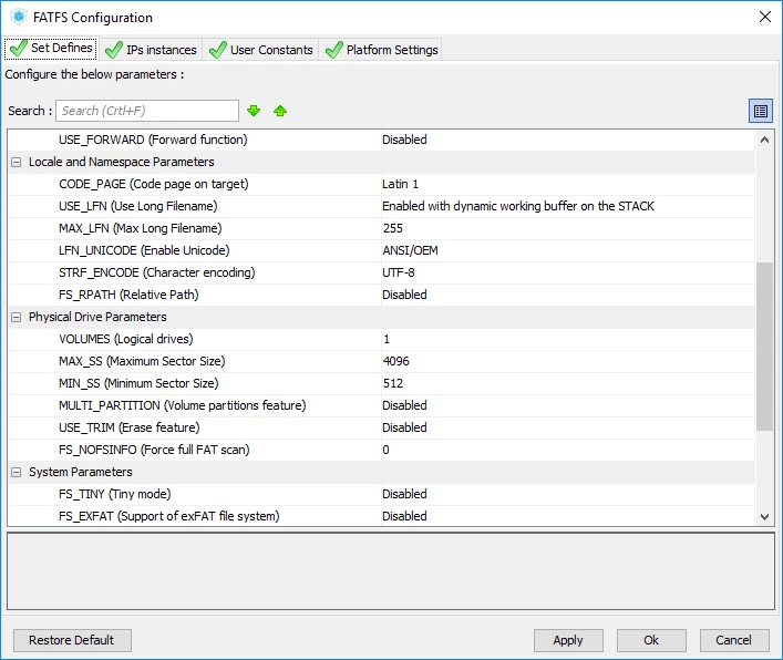

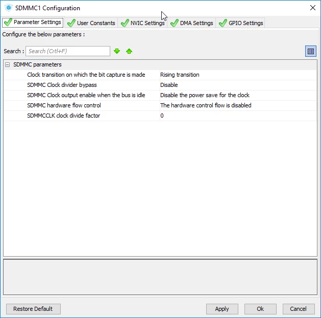

I also attached some screenshots, where I found differences between yours and my project configuration in CubeMX.
As you can see, I have SDMMC1 48MHz clock and SDMMCCCLK clock divider is set to 0. The DMA priority is Very High, but I don't think this should be an issue. Also, I don't use internal pull-ups since I have them externally. Finally, I enabled long filenames support in FatFs.

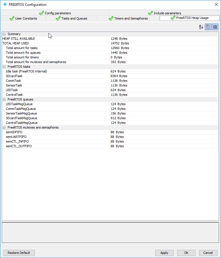

3) Now, I am trying to run sd card reading in rtos, but the program does not start. I thought that it could be lack of ram memory for task. I changed the task stack size from 128 to 256 and even to 512, but it did not help.
Do you know what could be the problem?

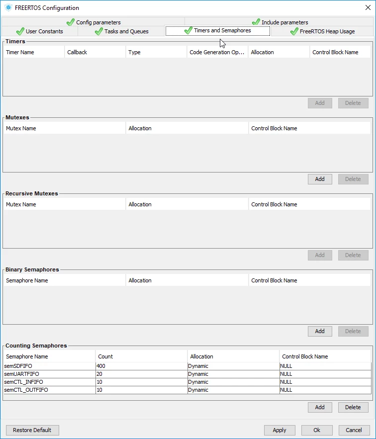

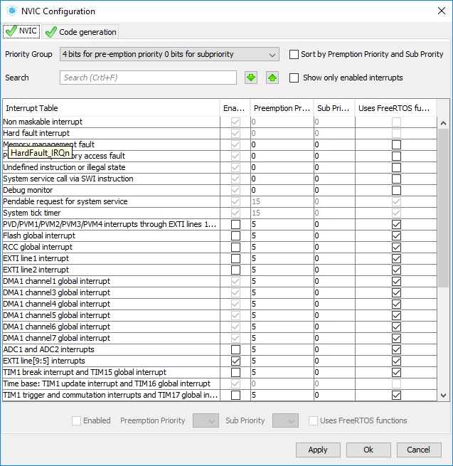

Could I ask you to share your freertos settings and nvic related to sd card reading?
Thank you in advance for your response.

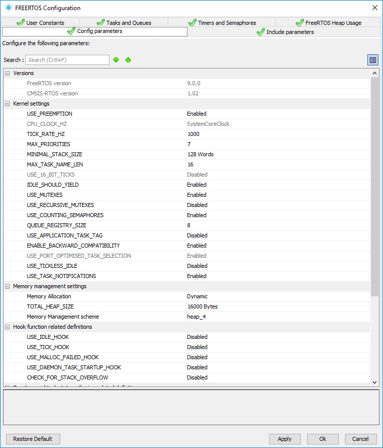

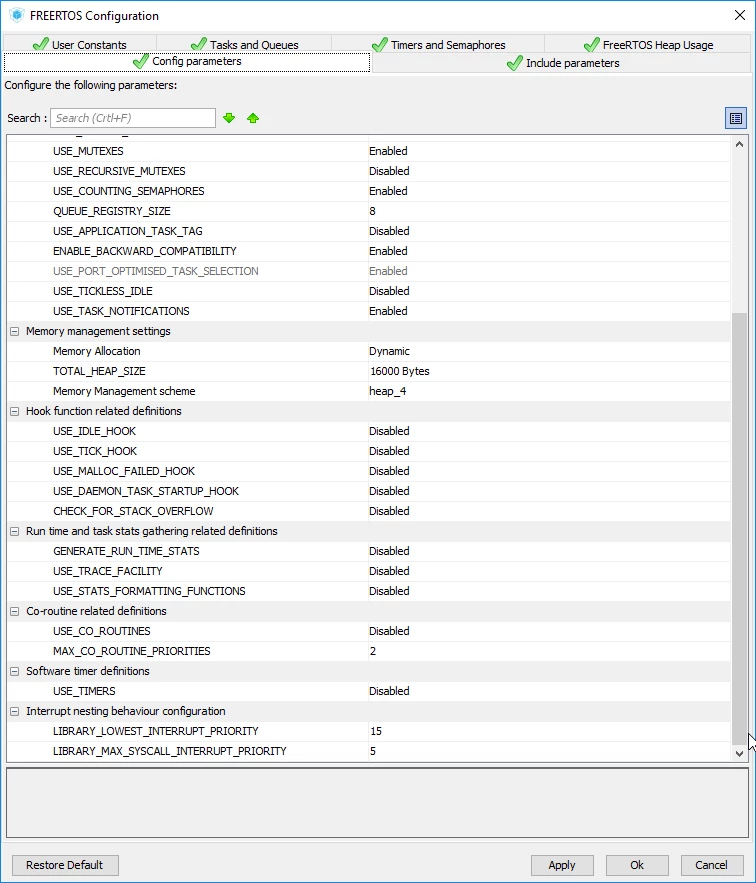

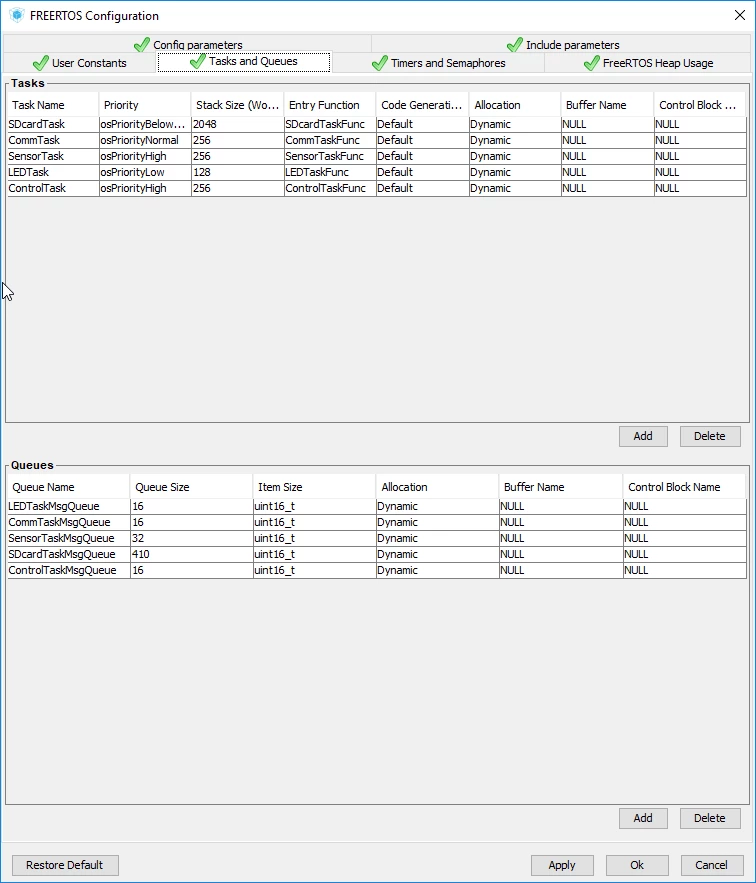

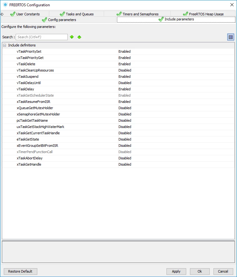

Evgeny Kirshin
May 2, 2018 4:12 PM UTC
Posted on May 02, 2018 at 16:12
Hi Dmitry,
If you set a breakpoint in your task, does it stop there? If not, it might be an issue with task priorities (although, you have only one task?) Also, have a look at heap size.
Here are the screenshots of the settings from my project.
0690X0000060AtVQAU.png0690X0000060AxCQAU.png0690X0000060AxHQAU.png0690X0000060AxMQAU.png0690X0000060AxRQAU.png0690X0000060AxvQAE.png0690X0000060AxWQAU.png0690X0000060AxgQAE.png
