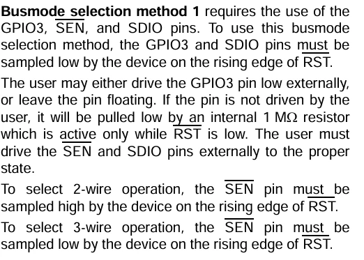

SDA pin is required low by SI4703 Datasheet at startup. How do i do it.
I am trying to make a very simple program that will initialize Si4703 and read data out of it, the manufacturer ID or something.
And in the datasheet, it says to initialize the chip, I need to have SDIO turned low on the rising edge of the RST pin.
Si4702/03-C19 (page 19)
So the problem is that I can't pull SDIO low because in the code, the SDA pin is initialized as I2C and not as a GPIO set in the configurator. In the Arduino Library, the SDA is set as output, then written low, and then I2C is initialized. Would something like that work in CubeIDE? I am new to programming embedded chips, and I want to know how I can solve this problem.
Using the blackpill board with STM32F411C6EU and the Si4703 Tuner Board

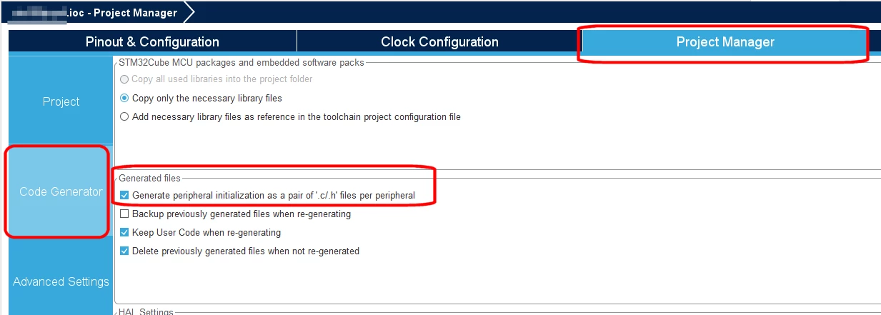

@Andrew Neil wrote:
You could use a separate CubeMX project to generate the GPIO config - then just copy that code into your "main" project with the I2C.
This is probably easier if you use the option to generate separate .c & .h files:
#GenerateCandH #SeparateCandH

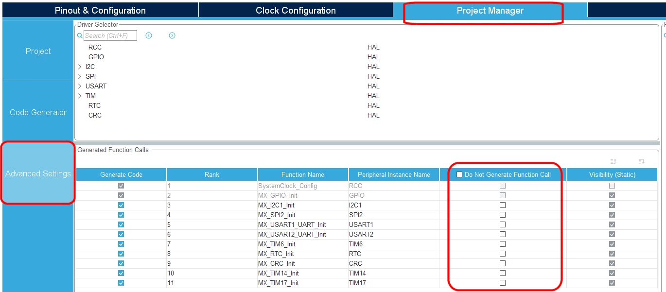

@Andrew Neil wrote:
You can configure CubeMX to have it not generate calls to some or all of its generated initialisation functions
Here:
#DisableInitCalls #DisableInitialisationCalls
