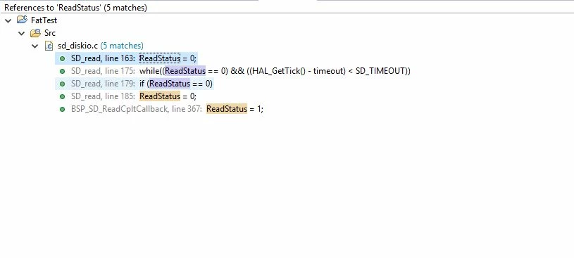

Good day everyone,
I'm not sure if this is a bug or I'm looking at this incorrectly, but It seems to be a bug.
While calling the f_mount function there is a point where SD_read is called.
DRESULT SD_read(BYTE lun, BYTE *buff, DWORD sector, UINT count)
DRESULT res = RES_ERROR;
ReadStatus = 0;
uint32_t timeout;
if (ENABLE_SD_DMA_CACHE_MAINTENANCE == 1)
uint32_t alignedAddr;
endif
if(BSP_SD_ReadBlocks_DMA((uint32_t*)buff,
(uint32_t) (sector),
count) == MSD_OK)
/* Wait that the reading process is completed or a timeout occurs */
timeout = HAL_GetTick();
while((ReadStatus == 0) && ((HAL_GetTick() - timeout) < SD_TIMEOUT))
/* incase of a timeout return error */
if (ReadStatus == 0)
res = RES_ERROR;
else
ReadStatus = 0;
while((HAL_GetTick() - timeout) < SD_TIMEOUT)
if (BSP_SD_GetCardState() == SD_TRANSFER_OK)
res = RES_OK;
the SCB_InvalidateDCache_by_Addr() requires a 32-Bit aligned address,
adjust the address and the D-Cache size to invalidate accordingly.
alignedAddr = (uint32_t)buff & ~3;
SCB_InvalidateDCache_by_Addr((uint32_t*)alignedAddr, count*BLOCKSIZE + ((uint32_t)buff - alignedAddr));
endif
break;
return res;
After this call my code enters
f(BSP_SD_ReadBlocks_DMA((uint32_t*)buff,(uint32_t) (sector),count) == MSD_OK)
and passes it successfully, after which it gets stuck in the while loop.
After this the problem occurs and that is:
res = RES_ERROR;
the function always gets stuck here no matter what. So i went and looked at all the calls for ReadStatus in my project and this popped up:
From here it seems there's one callback that will ensure the SD_Read passes and thats BSP_SD_ReadCpltCallback. Although this is never called anywhere in the project and therefore SD_Read always fails. Therefore it always remain 0 and the LL read function fails. This is cube generated.
Is this a mistake from my side or CubeMX??
I'm using the latest cube(V 4.0 and the latest Hal(1.8.0) for the stm32F7
f_mount-sdcard sdcard cubemx-project stm32f7-hal stm32f7

con3
con3Author
Senior
Nov 29, 2017 4:34 PM UTC
Posted on November 29, 2017 at 16:34
Thank you, the write function seems fine as it internally sets the write flag to 1, it looks like this was just forgotten in the read function

Amel NASRI
Dec 6, 2017 4:16 PM UTC
Posted on December 06, 2017 at 17:16
Hi
Reishauer.Ian
It seems you identified root cause of your issue as stated in
https://community.st.com/0D50X00009XkXg5SAF
For others having similar issues, please do the following:
1) Re-defineSD_initialize as following (in case code is generated with CubeMX 4.23):
Depending on you application requirement:
FreeRTOS not used:
In the generated file 'your_project/src/sd_diskio.c', re-define 'SD_initialize' as following:
DSTATUS SD_initialize(BYTE lun)
if(BSP_SD_Init() == MSD_OK)
Stat = SD_CheckStatus(lun);
return Stat;
FreeRTOS used:
Stat = STA_NOINIT;
* check that the kernel has been started before continuing
* as the osMessage API will fail otherwise
if(osKernelRunning())
* if the SD is correctly initialized, create the operation queue
if (Stat != STA_NOINIT)
osMessageQDef(SD_Queue, QUEUE_SIZE, uint16_t);
SDQueueID = osMessageCreate (osMessageQ(SD_Queue), NULL);
return Stat;
2) Apply the fix suggested by
Reishauer.Ian
‌ in the other discussions.
If you still face issues, please let us know about them.
-Amel
