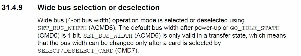

    The 4-bit SD Data Transfer Mode is Mandatory for High-Speed Cards, Optional for Low-Speed ones, so it depends on the used uSD card type. Otherwise, it's better to configure first the 1-bit SD Data Transfer Mode:
    hsd.Init.BusWide = SDIO_BUS_WIDE_1B;
    And then, just enable wide operation, for the 4-bit SD Data Transfer Mode:
    HAL_SD_WideBusOperation_Config(&hsd, SDIO_BUS_WIDE_4B);
    0690X00000602x0QAA.jpg 0690X00000602tXQAQ.jpg PS: You can refer to the stm324x9i_eval_sd.c/stm324xg_eval_sd.c BSP drivers, that may help you! Regards, Heisenberg.

    Late setting of 4-bit mode works (I checked it by scope on SD Card signal D3) but the function
    has to be called even after
    f_mount
    . Unfortunatelly, the file write still does not work reliably due to an interrupt (another issue). Regards Ivan
