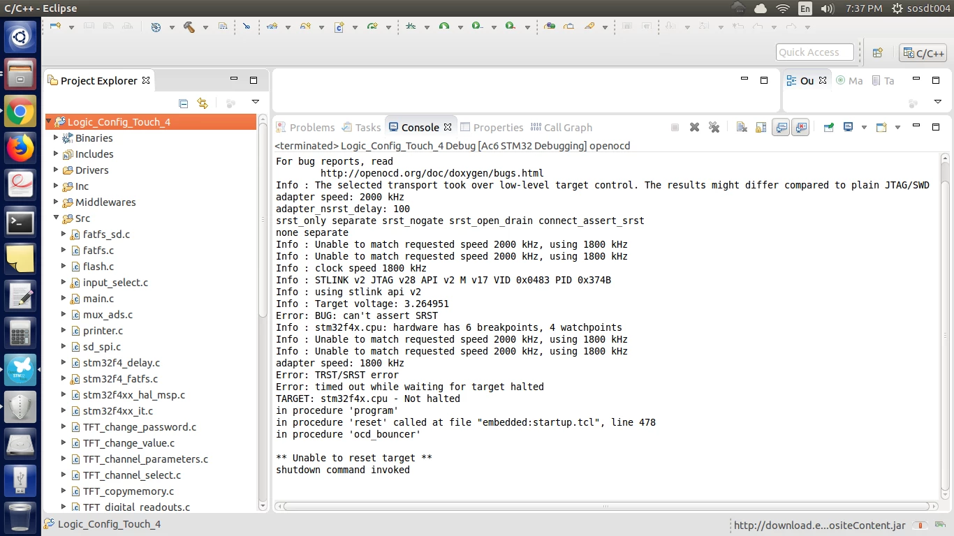

We are using ST32F405ZG and ST-Nucleo with a custom board design with SD card interface provision in it.
We are getting an error message as shown in the snap shot attached. Please provide some help in this issue.
    Those messages are your Eclipse IDE debugger failing to connect via the ST-Link - this has nothing to do with the SD Card interfacing!

    Thank you for the reply.
    I have gone through the code examples and found that the line below was missing in my code under the file 'Logic_Config_Touch_4.cfg' :
    reset_config srst_only srst_nogate
    This made the program to build and upload the program to the controller.
    But now the issue is SD card is not getting mounted using FATFS thirdparty library.
    The program executes and skips out of the mount function stating FR_INVALID_DRIVE
    now I got got stuckup at this point. Don't know what to do next...
    That has nothing to do with building the code - it is purely debugger configuration.
    Look at the FatFs documentation for information about the
    FR_INVALID_DRIVE error, and what constitutes a valid drive.
    Look at the code and see what are the possible causes of an
    FR_INVALID_DRIVE error.
    I meant - 'build and upload the program to the controller' because of that line it was not uploading the program to the controller.

    It says:
    FR_INVALID_DRIVE:
    Invalid drive number is specified in the path name. A null pointer is given as the path name. (Related option: FF_VOLUMES)
    We went through the check and identified that the path name is different and the SD card slot was not working. Later we changed the SD card slot and now its working fine and the file is generated.
