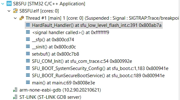

I have troubles porting SBSFU onto STM32F756ZGTx.
I took 1 image sample for STM32F769I as a base. I modified:
- STM32F756ZGTx_FLASH.ld (SECoreBin)
- STM32F756ZGTx_FLASH.ld (SBSFU)
- mapping_sbsfu.ld
- mapping_fwimg.ld
- Other changes to source code under SBSFU and SECoreBin to work with target platform.
Unfortunately, it still doesn't work and I'm not able to find out why.

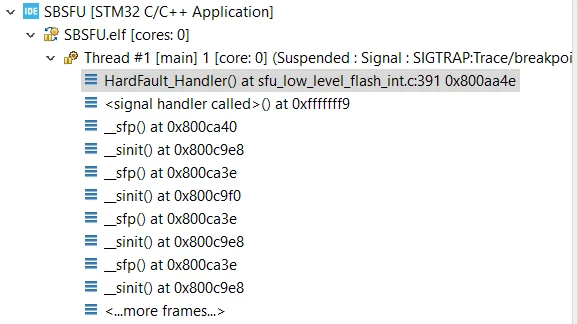

I connected debugger and every time programs ends up in a hard fault handler...
With SFU_MPU_PROTECT_ENABLE turned off:
With SFU_MPU_PROTECT_ENABLE turned on:

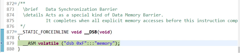

First debugger starts here
Then it fails upon calling SFU_BOOT_SystemSecurity_Config() -> SFU_COM_Init() -> setvbuf():
If necessary I can provide snippets of code. Thanks!
Jakub StandarskiBest answer
August 16, 2023
Problem solved. Issue came from missing line inside SBSFU linker script. So next time I should be more focused :)

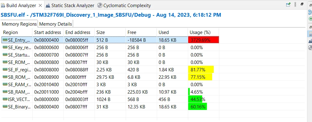

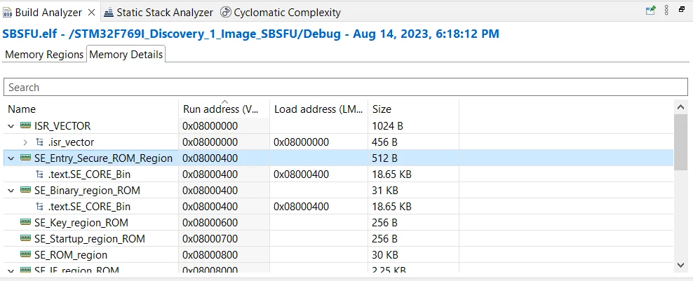

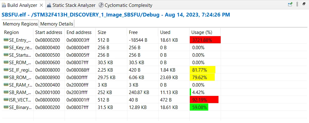

Thanks! I didn't solve the issue but did help finding this out:
That's the information from built in build analyzer for SBSFU.elf. I have no clue why SE_Entry_Secure_ROM_Region is that huge occupying 3729% of allocated memory.

3729%
Went a little over the top :grinning_face_with_sweat:
August 14, 2023
Just a little bit :D
I would like to know why since we are stuck on it for a long time. I saw similar thread on that forum but nobody replied to it.

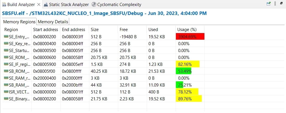

Okay, so that's weird, but I built two different sample projects:
  1. NUCLEO-L432KC (1_Image)
  2. STM32F413H-Discovery (1_Image)
Both presents same misleading information that there is some issue with memory mapping. The thing is that NUCLEO-L432KC works totally fine. Looks like it's not an issue with the build itself, but with the tool or naming used throughout linker files. Correct me if I'm wrong.
Jakub StandarskiAuthorBest answer
August 16, 2023
PS. It doesn't mean that tool or naming is fine. Build analyzer shouldn't show misleading information.
