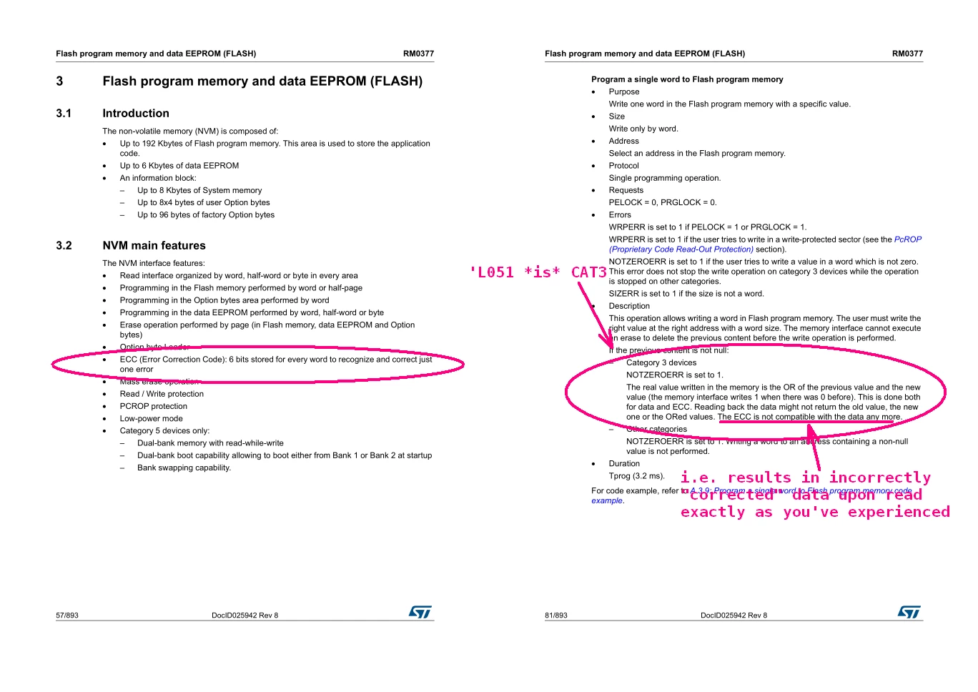

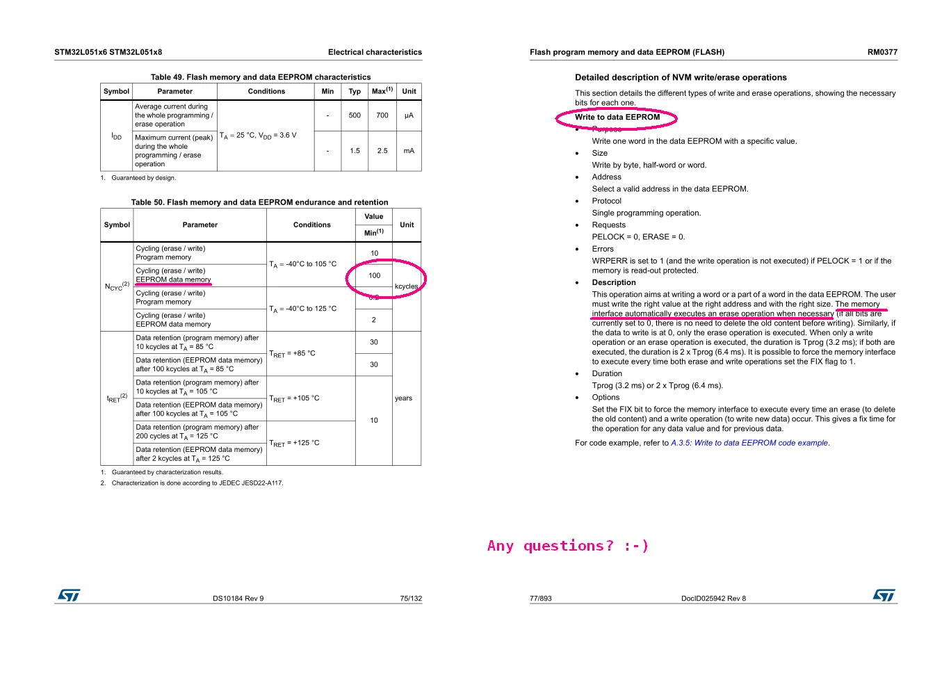

I want to realize a startup-counter in a STM32L0xxx MCU.
This means a counter which counts how often the MCU is doing a power fail and restart for the whole life.
I want to save the actual counter-value in the flash memory.
But I don't want to kill the flash-memory-cells with more than 10k write an erase-cycles.
To solve this I want to save the counter-value without erasing-cycles:
Is it possible to write to a flash-cell more than one time without an erase cycle if I only want to *set* the bits? I know it is not possible to clear a bit.
A flash page has a capacity of 128Bytes. If I use every single bit for a counter-step, I can save 128x8=1024 counter-steps without an erase-cycle.
I've tested this, but I get some strange effects.
Is there a reason for this effects?
Maybe multi-level-flash-cells or ECC-correction?

The following happens:
At an erased page all bits are cleared to 0.
My CPU (STM32L051) supports only a 32-Bit Flash HAL writing method (FLASH_TYPEPROGRAM_WORD).
For example:
Start at a flash adress with value 0x00000000
first set to 0x000000FF -> works
second set to 0x0000FFFF -> works
third set to 0x00FFFFFF -> works
at the next step I want to set it to 0xFFFFFFFF
and I get 0xBFFFFFFF back
Best regards
Andreas

Journal a write of words over a whole sector, pick the largest one, and increment that putting it in the next cell. Erase when you fill the whole sector, writing the old count at the front.
Tesla DeLorean
Guru
March 29, 2019
Not multi-level, but the flash lines are quite wide and 32-bits have additional bits of ECC/Hamming, which is why changing the word breaks things.
I don't see them mention it, but I'd assume at least 4-bits, so 32-bit stored as 36-bit. Sure you could extract specifics from an FAE.
