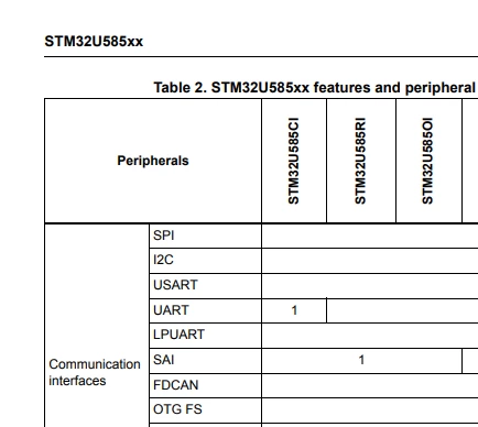

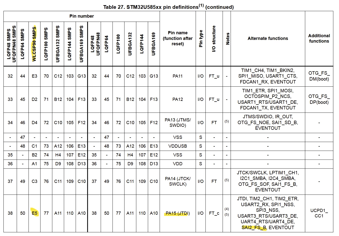

The datasheet for STM32U585 and 575 list there are two SAI on the chip. In CubeMX I can only see SAI1 (A and B sub-blocks)
Datasheet

No, from U585 ds :
On STM32U585OI one SAI avail.
