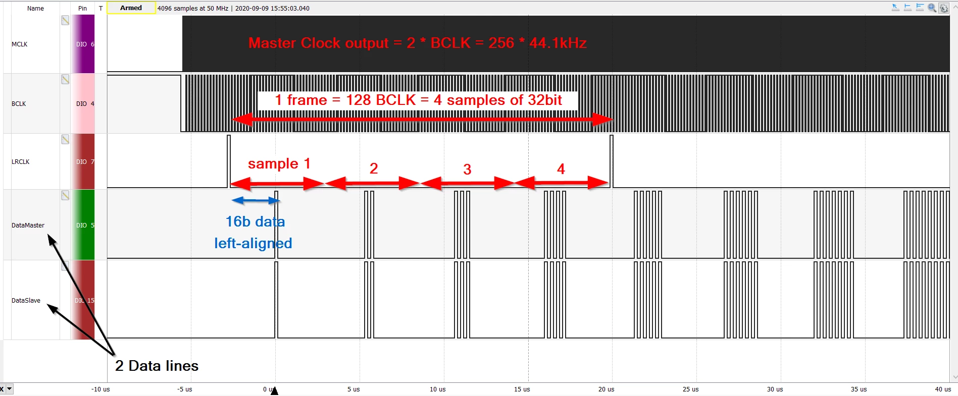

I am still playing with the SAI of my STM32F446RE. It has one SAI (SAI1) which has two blocks, A and B.
The idea is to use the two blocks synchronously in TDM mode to transmit in total 8 slots, 4 slots for each block.
I can get it to work fine, though I noticed the two blocks do not necessarily send the data at the same time - i.e. as soon as I put something in the DR registers it gets sent. I went through the datasheet and a few PDF presentations multiple times, but I still do not get how I can get the 2 blocks to send the data at the same time (for example I put 4 bytes in each block, then say "go" and the 8 bytes are sent together using the 8 slots - i.e. one frame).

I tested the DMAPause/Resume and I can confirm it gets out of sync when resuming. BUT it turns out that within one frame the data is still where it should be - so that the data is still sent to the correct audio output (see below).
Though the slave and master can still be one frame out of sync, and can get more and more out of sync each time the HAL_SAI_DMAPause/Resume functions are called.
Notice that in terms of audio one frame out of sync means some audio channels will be 1/fs out of phase, f.x. 0.02ms (with fs=44.1kHz) - I am thinking this should not be audible really?
Here is my test setup:

When I start the SAIs I get that:
So far so good, you can see both data lines are in sync, and also that the data is in the right place in the frame (since this is TDM, the DAC will send the samples to different outputs according to their position in the frame).

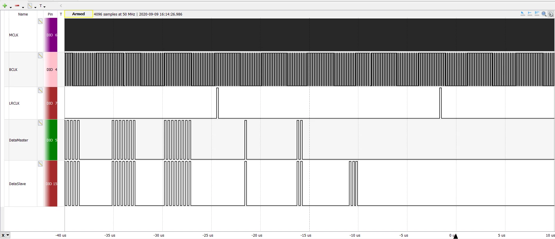

Then I press the button (calling HAL_SAI_DMAPause) and it does not (always) stop at the end of the frame, nor does the two data lines stop at the time (again: not always).

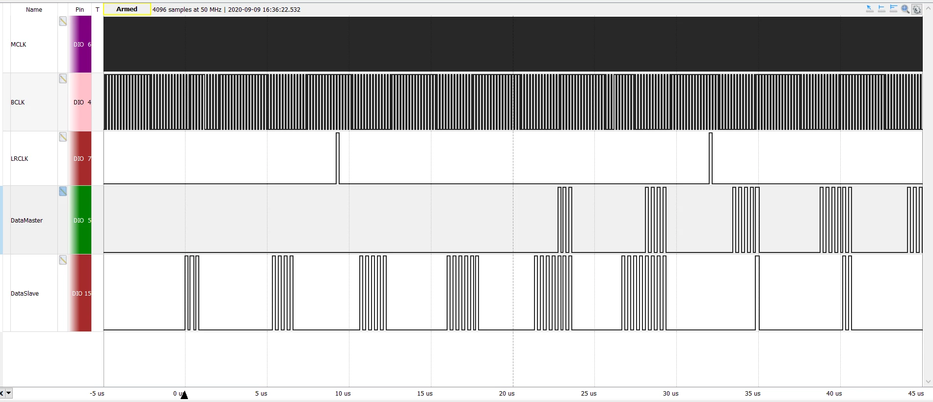

When I press again (calling HAL_SAI_DMAResume), and it seems the DMA/SAI make sure that the data within each frame is at its place, but since one SAI starts transmitting a bit before the other, then the other come one frame later sometimes, like here:

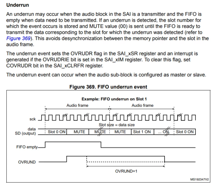

If I am not mistaken, here stopping the DMA simply means the FIFO is empty and is contantly in "underrun" until the DMA is resumed?
As the UM explains:
I guess I am doing something wrong here - I keep reading the UM, and even going through the registers it seems the only way to stop sending data from the FIFO (sending zeros if it is empty as shown in the screenshot above) is to disable the SAI with SAIEN=0. Problem is when I disable the master then the Master Clock stops being output.
