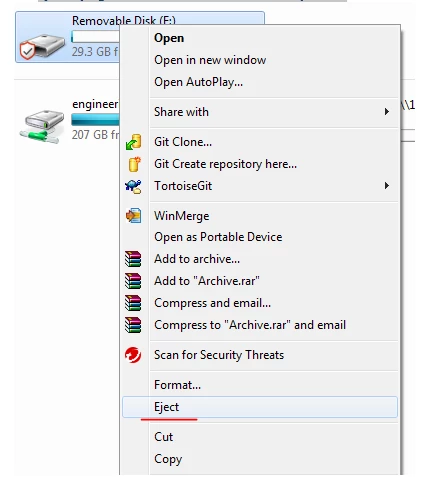

I'm developing USB MSC features with chip STM32F779 using SD Card .
Now I can read/write/format data in SDcard.
But there is 1 issue is I can not do Safe Eject the USB from Window.
Window said that the device is “safe to remove�? but actually USB device still there and can read/write as usual.
So does USB stack support any event to detect USB safe eject ? And What is the proper way to do this ?

    Posted on June 06, 2018 at 12:01
    could any one help me on this issue ?
    I see the issue is when I eject from USB icon on the right corner of the Window, it is ok.
    But when  I eject by right click USB Drive in Window Explorer it not ok .
