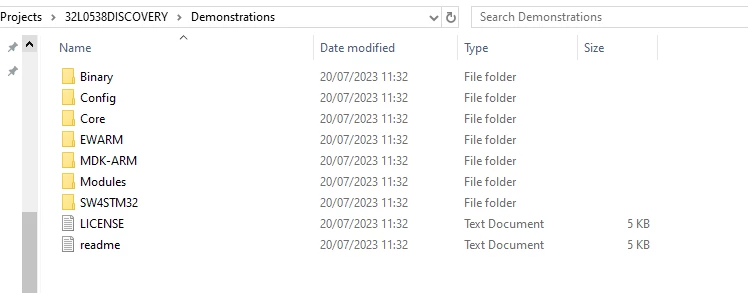

1. The first step in the guide mentions that I need to make a copy of the project and copy that inside the workspace currently being used in STM32CubeIDE. I cannot understand how to properly do that. First of all, when it refers to "make a copy of the project" which directory does it refer to exactly?
Does it refer to whole Demonstrations directory?
C:\Users\petrikas.lu\STM32Cube\Repository\STM32Cube_FW_L0_V1.12.2\Projects\32L0538DISCOVERY\Demonstrations\SW4STM32\STM32L0538-Discovery
Does it refer to SW4STM32 directory?
Or STM32L0538-Discovery directory?
Additionally, which files exactly do I need to copy?
2. It also mentions that I need to copy those files to already open workspace. Does it mean that I need to create a blank project for the STM32L053? I do not get how can I have workspace already open prior to creating a project?
3. Perhaps there is an easier way to get the most basic E-Paper example running on STM32L0538-Discovery board? I am not interested in the touch bar or anything else. I just want to display some text on the e-paper  for example "Hello World"  before moving to more complex tasks.

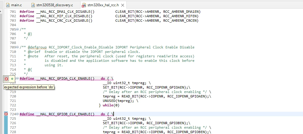

However, since I created a blank project using stm32CubeMX, I cannot build the project perhaps I am missing some configuration:
make -j16 all
arm-none-eabi-gcc "../Drivers/BSP/STM32L0538-Discovery/stm32l0538_discovery.c" -mcpu=cortex-m0plus -std=gnu11 -g3 -DDEBUG -DUSE_HAL_DRIVER -DSTM32L053xx -c -I../Core/Inc -I../Drivers/STM32L0xx_HAL_Driver/Inc -I../Drivers/STM32L0xx_HAL_Driver/Inc/Legacy -I../Drivers/CMSIS/Device/ST/STM32L0xx/Include -I../Drivers/CMSIS/Include -O0 -ffunction-sections -fdata-sections -Wall -fstack-usage -MMD -MP -MF"Drivers/BSP/STM32L0538-Discovery/stm32l0538_discovery.d" -MT"Drivers/BSP/STM32L0538-Discovery/stm32l0538_discovery.o" --specs=nano.specs -mfloat-abi=soft -mthumb -o "Drivers/BSP/STM32L0538-Discovery/stm32l0538_discovery.o"
In file included from ../Core/Inc/stm32l0xx_hal_conf.h:188,
 from ../Drivers/STM32L0xx_HAL_Driver/Inc/stm32l0xx_hal.h:29,
 from ../Drivers/BSP/STM32L0538-Discovery/stm32l0538_discovery.h:48,
 from ../Drivers/BSP/STM32L0538-Discovery/stm32l0538_discovery.c:40:
../Drivers/BSP/STM32L0538-Discovery/stm32l0538_discovery.c: In function 'BSP_LED_Init':
../Drivers/STM32L0xx_HAL_Driver/Inc/stm32l0xx_hal_rcc.h:724:40: error: expected expression before 'do'
 724 | #define __HAL_RCC_GPIOB_CLK_ENABLE() do { \
../Drivers/STM32L0xx_HAL_Driver/Inc/Legacy/stm32_hal_legacy.h:2829:28: note: in expansion of macro '__HAL_RCC_GPIOB_CLK_ENABLE'
 2829 | #define __GPIOB_CLK_ENABLE __HAL_RCC_GPIOB_CLK_ENABLE
../Drivers/BSP/STM32L0538-Discovery/stm32l0538_discovery.h:104:49: note: in expansion of macro '__GPIOB_CLK_ENABLE'
 104 | #define LED3_GPIO_CLK_ENABLE() __GPIOB_CLK_ENABLE()
../Drivers/BSP/STM32L0538-Discovery/stm32l0538_discovery.h:112:71: note: in expansion of macro 'LED3_GPIO_CLK_ENABLE'
 112 | #define LEDx_GPIO_CLK_ENABLE(__INDEX__) (((__INDEX__) == 0) ? LED3_GPIO_CLK_ENABLE() : LED4_GPIO_CLK_ENABLE())
../Drivers/BSP/STM32L0538-Discovery/stm32l0538_discovery.c:154:3: note: in expansion of macro 'LEDx_GPIO_CLK_ENABLE'
 154 | LEDx_GPIO_CLK_ENABLE(Led);
../Drivers/BSP/STM32L0538-Discovery/stm32l0538_discovery.c: In function 'BSP_PB_Init':
../Drivers/STM32L0xx_HAL_Driver/Inc/stm32l0xx_hal_rcc.h:716:40: error: expected expression before 'do'
 716 | #define __HAL_RCC_GPIOA_CLK_ENABLE() do { \
../Drivers/STM32L0xx_HAL_Driver/Inc/Legacy/stm32_hal_legacy.h:2823:28: note: in expansion of macro '__HAL_RCC_GPIOA_CLK_ENABLE'
 2823 | #define __GPIOA_CLK_ENABLE __HAL_RCC_GPIOA_CLK_ENABLE
../Drivers/BSP/STM32L0538-Discovery/stm32l0538_discovery.h:128:49: note: in expansion of macro '__GPIOA_CLK_ENABLE'
 128 | #define KEY_BUTTON_GPIO_CLK_ENABLE() __GPIOA_CLK_ENABLE()
../Drivers/BSP/STM32L0538-Discovery/stm32l0538_discovery.h:133:50: note: in expansion of macro 'KEY_BUTTON_GPIO_CLK_ENABLE'
 133 | #define BUTTONx_GPIO_CLK_ENABLE(__INDEX__) (KEY_BUTTON_GPIO_CLK_ENABLE())
../Drivers/BSP/STM32L0538-Discovery/stm32l0538_discovery.c:222:3: note: in expansion of macro 'BUTTONx_GPIO_CLK_ENABLE'
 222 | BUTTONx_GPIO_CLK_ENABLE(Button);
make: *** [Drivers/BSP/STM32L0538-Discovery/subdir.mk:34: Drivers/BSP/STM32L0538-Discovery/stm32l0538_discovery.o] Error 1
"make -j16 all" terminated with exit code 2. Build might be incomplete.
11:42:20 Build Failed. 3 errors, 0 warnings. (took 362ms)
It is quite strange why I am getting errors such as this after adding BSP inside my Drivers folder:

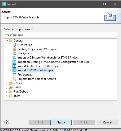

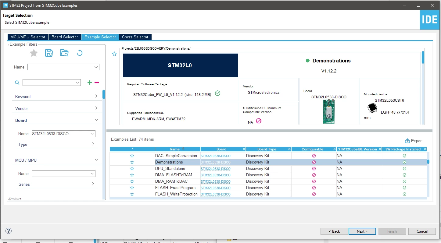

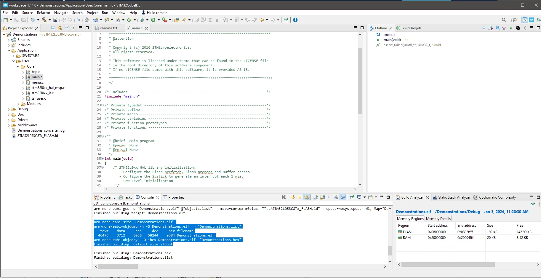

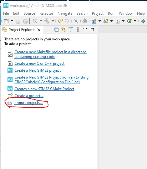

I suggest you to import 32L0538-Discovery Demonstration in this way:
1°) Start from STM32CubeIDE, and in Project Explorer select Import projects...
2°) In import Wizard choose STM32Cube Example, and click Next.
3°) In the example selector, set the Board filter to STM32L0538-DISCO, the search in the project list Demonstration project. Then click Next and Finish to copy the full project and libraries in your STM32CubeIDE workspace. The folder SW4STM32 will be migrated to STM32CubeIDE.
4)) After that, you can edit, compile and debug the Demonstration project with STM32CubeIDE.
if you check Project Properties, in Resource, Linked Resources, you will find the Path variables PROJECT_LOC is located in your workspace.
Let me know if it help you?
Best regards.
Romain
LPetr.1
LPetr.1Author
Senior
January 3, 2024
Yes I am able to compile and flash the device using the methods you have suggested above! Thank you very much. This is much easier than what is explained in the Migration guide document.
