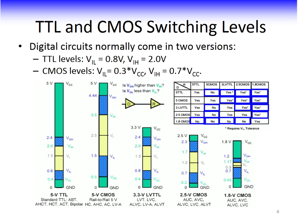

MAybe logic levels should be taken into account when connecting uart to external circuitry (level shifter might be needed):
Bogdan Golab
Lead
Mar 3, 2018 10:43 PM UTC
Posted on March 03, 2018 at 22:43
Forgot to add a link:
http://homepage.cem.itesm.mx/carbajal/Microcontrollers/SLIDES/GPIO_Applications.pdf
