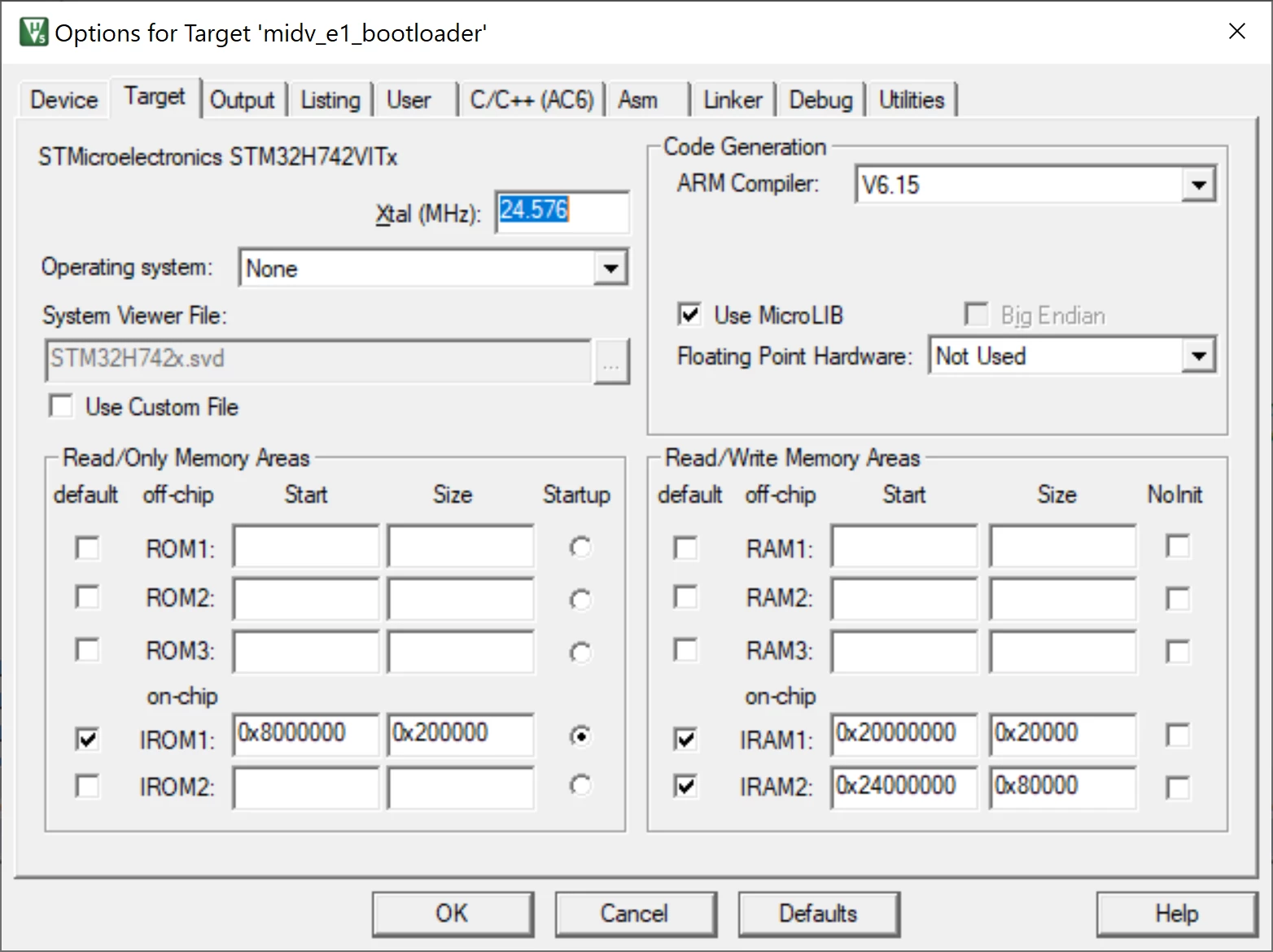

Running into restricted memory issues with STM32H742VIT6?
I'm having issues with software behaving inconsistently and freezing when I add certain lines, try to access certain variables, etc.  I suspect maybe it has something to do with the restricted flash regions in the MCU.  Is there any way around this?  Can I "democratize" the whole flash and eliminate all of these restrictions somehow?
Here are my ROM/RAM settings in my project in Keil, if it is helpful for answering my question: options_target.png
Thanks to anyone who can help make my project compile and run according to my actual code!

Hello, I am using Keil uVision V5.29.0.0.
I am confused about how to use this SBC command.  Do I include it somewhere in the target settings for the project?  Or write it at the top of main.c?

What do you mean by "the restricted flash regions in the MCU" ? which regions you are referring to? and what are you trying to do?
briankaz
briankazAuthor
December 5, 2023
I am referring to this in the reference manual:
"Flash memory enhanced protections, activated by option bytes
– Read protection (RDP), preventing unauthorized Flash memory dump to safeguard sensitive application code
– Write-protection of sectors (WRPS), available per bank (128 Kbyte sectors)
– Two proprietary code readout protection (PCROP) areas (one per user Flash bank). When enabled, this area is execute-only.
– Two secure-only areas (one per user Flash bank). When enabled this area is accessible only if the STM32 microcontroller operates in Secure access mode."
Maybe this doesn't apply to me since I didn't activate any option bytes...
I'm also a bit confused about where these RAM address settings come from in the project settings:
IRAM1: Start 0x20000000 Size 0x20000
IRAM2: Start 0x24000000 Size 0x80000
I meant maybe the MCU is sometimes trying to write/read RAM where it's not allowed?
Thanks!
