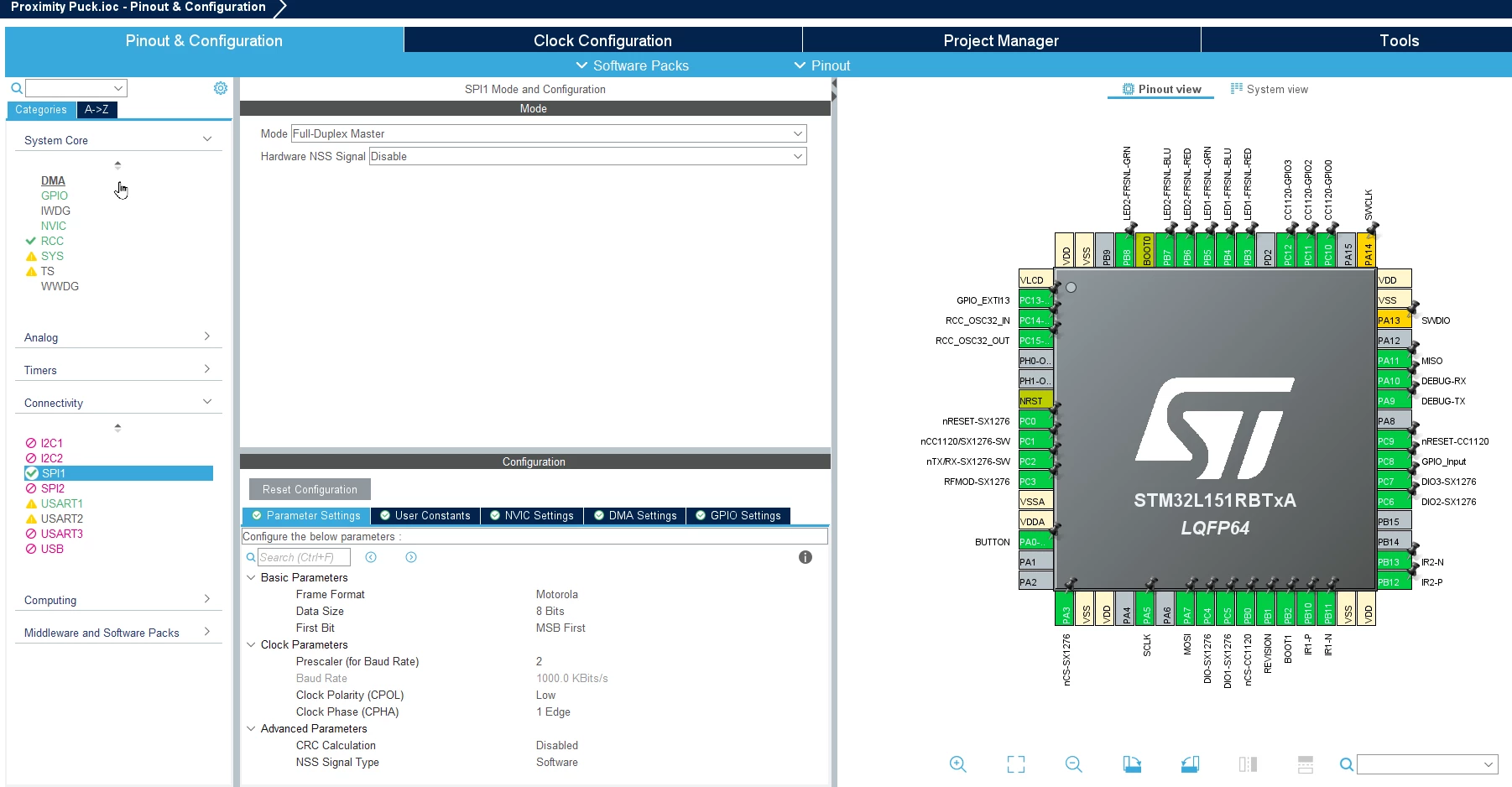

I am using STM32cubeIDE ver 1.15.1, generating C code. Code for all I/O functions work fine, except the SPI. In fact, whenever I try to excercise the SPI, the CPU resets. The nRST line on the CPU glitches to 0V and then resets. Nothing Is driving that reset line, other than the S-LINK/V2, so the reset is happening within the STM32L151.

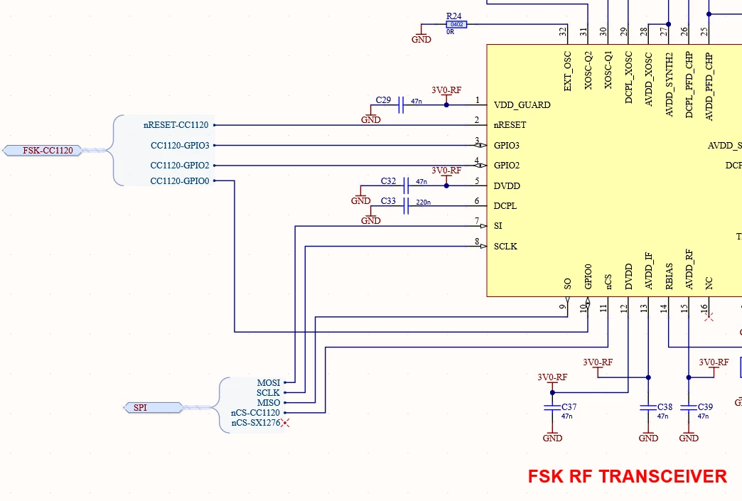

The application is driving on the SPI port two RF chips: the CC1120 and the SX1276. I have checked SPI various lines and there are no shorts and no obvious schematic errors. Both have independent SPI chip selects. Also the RF chips are not producing any RF - the digital signals are all clean.
I was using the SPI nCS line (NSS), with software control from the .ioc file, and thinking there was an issue there for the CC1120, I cut a track and rerouted that signal to PB0. Still same bug.
I have read code examples and even used ChatPGT to generate code. Nothing fixes the issue.

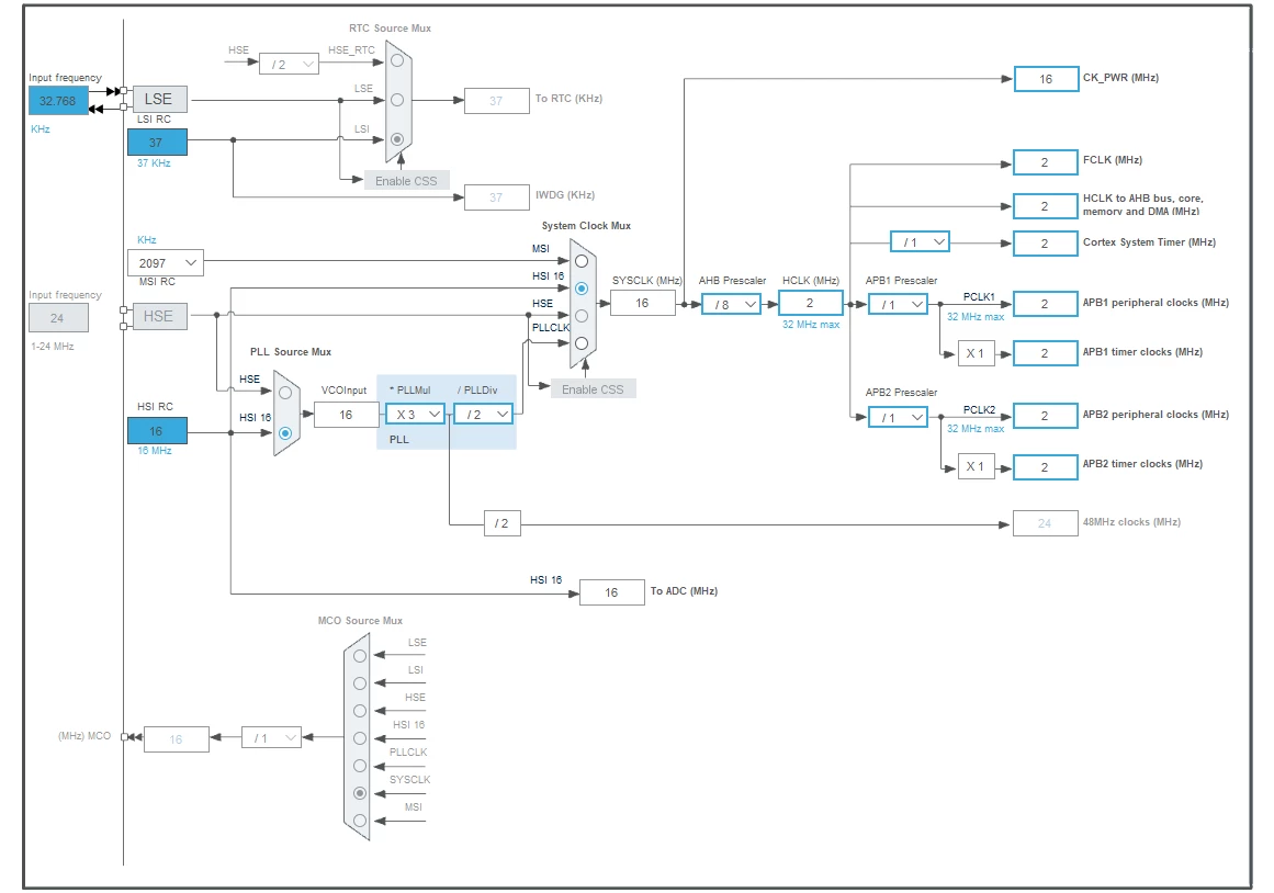

I have attached some screen shots of the schematic. The rail voltages are all 3.0V. Here is a test while(1) loop in main.c, simplified as to not cause confusion. As you can see, I have tried this with having the CC1120 and SX1276 stuck in reset, and only one in reset and none in reset - but no luck.
This is puzzling!

The SPI config is as such:

I THINK I FOUND THE CAUSE!
It was that 10K resistor to VDDA. I only put it in there due to a legacy issue on an earlier design by an engineer who died suddenly last year, so I could not ask him why he put that in.
Chat GPT 4 actually say the voltage on the VDDA is important, and if it has the wrong voltage on it (eg: 10K will drop it), it will cause resets from the SPI! ChatGPT is remarkable.
