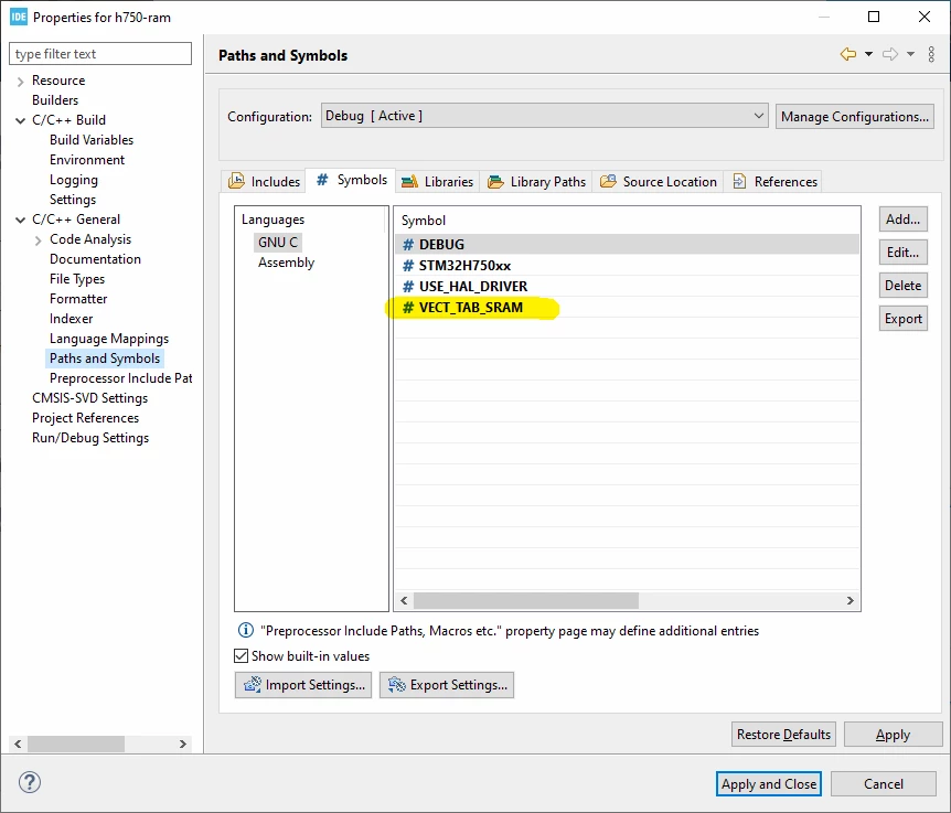

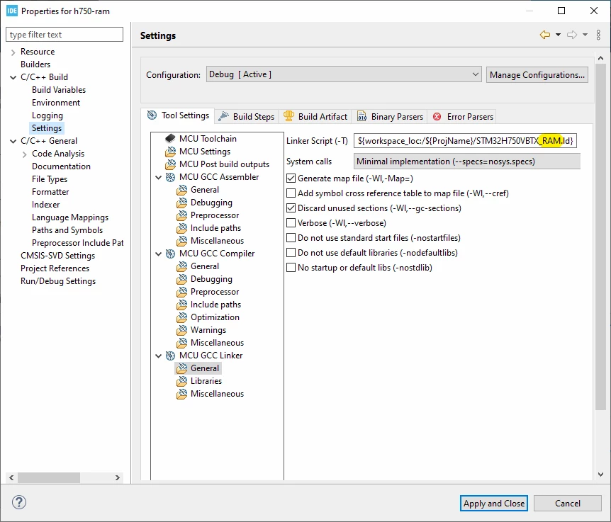

I have developed a custom bootloader that works both from FLASH and RAM of STM32H7. What you need is:
  1. Go to Project → Properties → C/C++ Build → Settings → Tool Settings tab → MCU GCC Linker
  2. Set Linker Script to ${workspace_loc:/${ProjName}/STM32H750VBTX_RAM.ld}
  3. Go to Project → Properties → C/C++ General → Paths and Symbols → Symbols tab
  4. Add symbol VECT_TAB_SRAM
  5. Then you can run your program through Debug.
Make sure you arrange memory regions right if you use DMA. Google on VECT_TAB_SRAM to get more related information.
