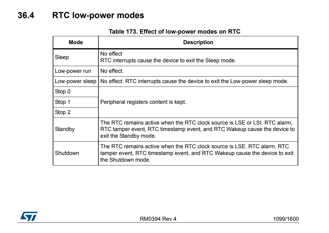

RTC Wakeup does not wakeup system from sleep mode STM32L431?
Hello, I'm using RTC Wakeup to periodically kick WDG while system is in a sleep mode.
I have setup RTC wakeup as following:

and then before going to sleep:
 * @brief Activates/Deactivates wake up timer to wake up system from sleep mode and reset IWDG. It is configured
 with assumption that IWDG will be configured with 32 seconds timeout before entering sleep
 mode

Now the problem is that RTC Wake up interrupt triggers and it changes is_stay_in_sleep_mode to true, but __WFI() instruction does not exit for some reason. And what happens next is that, when wake up from UART or CAN is received it does not wake up the system, because is_stay_in_sleep_mode is set to true.
Does anyone know WHY Wakeup interrupt does is ignored by HAL_PWR_EnterSLEEPMode(PWR_LOWPOWERREGULATOR_ON, PWR_SLEEPENTRY_WFI);

is_stay_in_sleep_mode variable is volatile ?
And check if wakeup is designed or setup for wake from sleep. Normal usage is wake from standby...

  1. Yes
  2. According STM reference manual
0693W00000KbweIQAR.pngAlso update on behaviour.
When the wake up interrupt is generated, system does not leave __WFI() instruction.
But when interrupt from UART comes, then it moves out form ISR instruction, and on the next wake up interrupt it starts working as it should.

March 9, 2022
Anyway, since RTC does not wake up system anymore, I have removed is_stay_in_sleep_mode, and now it simply waits in HAL_PWR_EnterSLEEPMode() until wake up ISR from other peripherals is triggerred.
