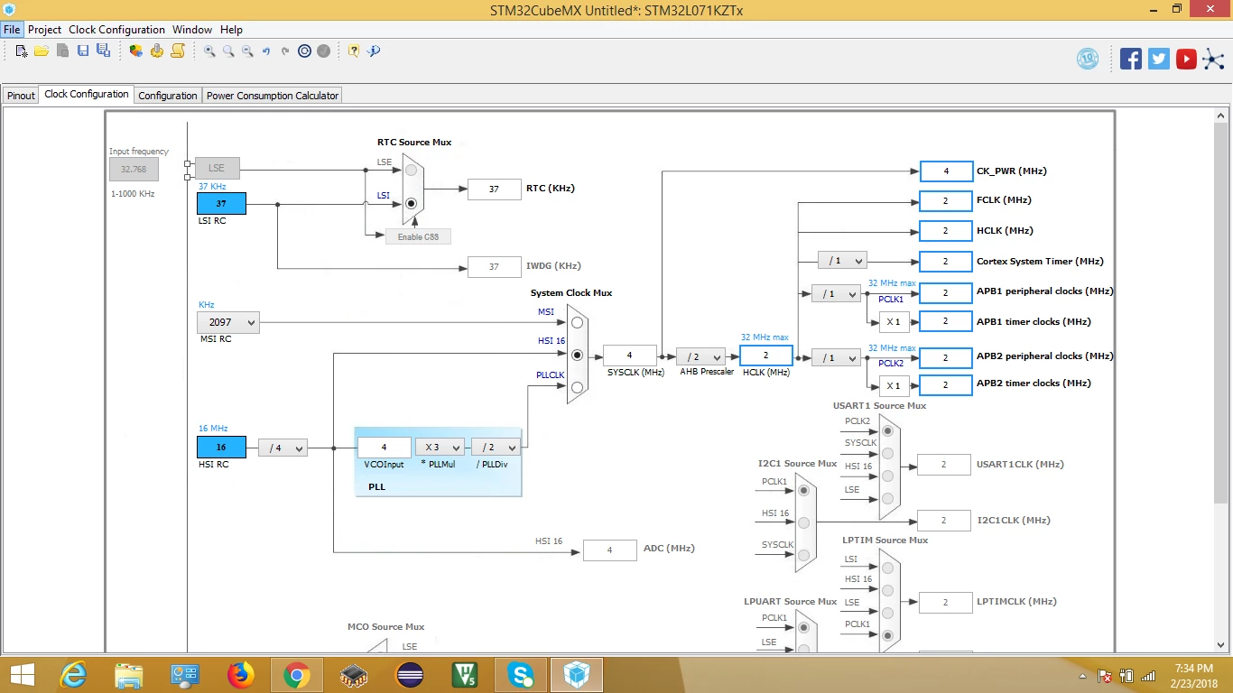

hi,
I have set internal clock frequency 1Hz but RTC time is faster than the real time
I have stm32l0 rtc clock LSI with 37khzPREDIV_A=125 andPREDIV_S =296

    Posted on February 23, 2018 at 14:58
    Product isn't 37000 is it?
    You should perhaps also quantify LSI via MCO pin

    Posted on February 23, 2018 at 15:09
    above image RTC Clock is 37khz
