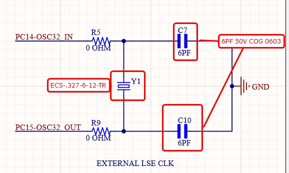

Schematic
The LSE circuit follows the standard two-cap topology:
  • PC14 (OSC32_IN) → 0Ω series resistor R5 → crystal Y1 (ECS-.327-6-12-TR) → 0Ω series resistor R9 → PC15 (OSC32_OUT)
  • Load capacitor C7 (6pF) from OSC32_IN pin to GND
  • Load capacitor C10 (6pF) from OSC32_OUT pin to GND
  • Both capacitors are 6PF 50V COG 0603
Schematic
PC14-OSC32_IN  --[R5 0Ω]--+--[C7 6pF]-- GND
[Y1] ECS-.327-6-12-TR
PC15-OSC32_OUT --[R9 0Ω]--+--[C10 6pF]-- GND

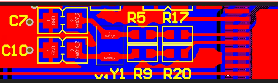

PCB Layout
In the PCB view, the crystal Y1 is placed between the two load capacitors C7 and C10. Series resistors R5 and R9 are placed inline on the OSC32_IN and OSC32_OUT traces respectively.
PCB Layout

  1. Our hardware uses a 6 pF crystal with 6 pF load caps — but effective CL seen by the crystal includes PCB stray capacitance (typically 1–3 pF per node). Could the mismatch between crystal CL spec and effective board CL be contributing to the higher drift at lower drive levels?

Dear ​@RahulBaraiya ,
The comment here from ​@MM..1 is key ! You need to know if the drift is positive or negative each time And then go step by step . To start first by physics on the Crystal oscillation  if running slower or faster than nominal (+/- 50ppm) .
if running faster that means your CL1=CL2 should be increased from 6pF to 8 or 10pF and try again .
the pullability of a crystal of CL=6pF is high versus 9pF or 12.5pF ( best in class for accuracy but higher consumption) .
Drive level on LSE is indeed to allow different options based on your crystal Usage  and is important for start-up condition ton have right margin to start-up .

Start with reading AN2867. There are guidelines there, toghether with layout examples.
The key issue often is the return/ground from the “burden” capacitors - it must be a dedicated track to the VSS pin, i.e. not shared/going through a common ground track or plane; and as short as possible.
Also note, that the load capacitance given as parameter to the crystal is NOT equal to the value of individual capacitors. Again, AN2867 contains the info you need.

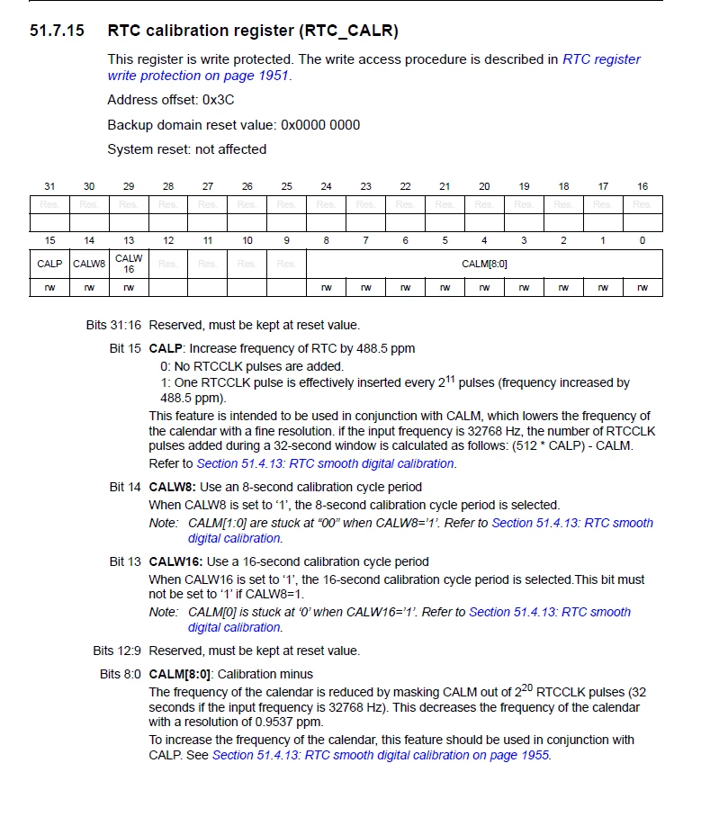

Take one eval board - any STM32xxxx product - move from ambient to hotter or cooler and you drift seconds or even minutes per day.
Obvioulsy, if you use external TCXO you can get several orders of magnitude better stability, but not on long time periods.
As you are using H7xx, you have network connection, and you can use RTC calibration register to match network reference in a closed loop - same if you have some gps with pps or any freq.
I usually get precision < 5/256 s adjusting internal trim once every hour or less according to offset - for my iot is enough; you can get even better reasult if required.
