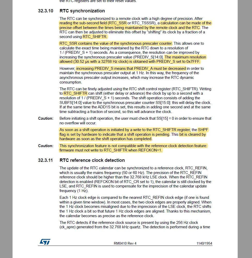

How do you add milliseconds when programming an hour?
I know how to convert milliseconds into SubSeconds.
But the HAL_RTC_SetTime function does not apply them.
A Maq
April 24, 2020
@pierre-yves​  I am glad it was helpful.
In order to add milliseconds you have to use Sub-Second register of RTC that is (SSR)
Register itself is Read Only therefore you cannot write anything on it.
Therefore we have to use a SHIFTR register of the RTC to perfom that.
A Maq
April 24, 2020
If you look at the last section of the STM32F7 Reference Manual RTC synchronization that tells you about how to advance or delay adding into SSR using SUB bits of SHIFTR.
