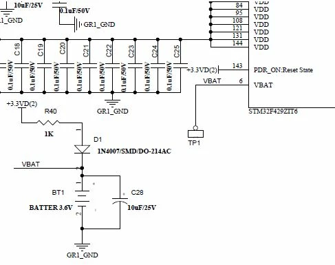

With STm32F429ZIT6 the RTC battery used is 3.6V Ni-Cd and the RTC crystal used is 32.768khz. Initially, it works well for some days but after 1-2 months RTC date and time get reset to default value every time system is power reset.
Need help to resolve this ASAP.

StudentWei
November 20, 2021
Did you test the voltage​ of the Ni-Cd battery?
APAL.1
APAL.1Author
November 20, 2021
yes the voltage was 3.5 to 3.4 volts

MM..1
November 20, 2021
Yes 3.4V is very discharged NiCd
APAL.1
APAL.1Author
November 22, 2021
I tried replacing the battery but still, the problem persists. but if I replace the mico controller with a new one then the problem is solved. But that is not the required solution.

November 22, 2021
If replacing the micro fixes it, the microcontroller is probably damaged. Keep in mind the max voltage you can put into VBAT and make sure you're under it at all times.
Any battery that has the proper voltage output range will work, such as a CR2032. NiCd batteries are very old/poor technology and aren't used much anymore.

MM..1
November 23, 2021
Maybe help show schematics, seems as your BAT connection have an issue
