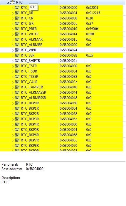

DMast.1
DMast.1Author
February 15, 2021
Good morning JW,
attached the RTC register status after initialization.
Now I'm modifing my project to get and test a minimal setup.
Thanks,
DM

waclawek.jan
February 16, 2021
> even if this value is not suggest by cristal manifacturer.
What the crystal manufacturer suggests as loading capacitance is not equal to the capacitance of capacitors you should place next to the crystal. Don't forget, that those two capacitors are effectively in series, and also that there are significant parasitic capacitances on your board (the pin's parasitic capacitance, plus the tracks). Read AN2867.
Unfortunately, those parasitics are hard to determine. Also, as you've mentioned, the oscillator "drive" does influence the frequency, too. Also, there may be noise sources on the board which may influence the oscillator, so it's not a simple task to arrive at a precise timing. 5 sec / 24 hours is roughly 60ppm, which is not stellar, but also not quite bad.
If your oscillator is stable even if not precise, you can fine-tune it digitally, read RTC smooth digital calibration subchapter of RTC chapter in RM.
