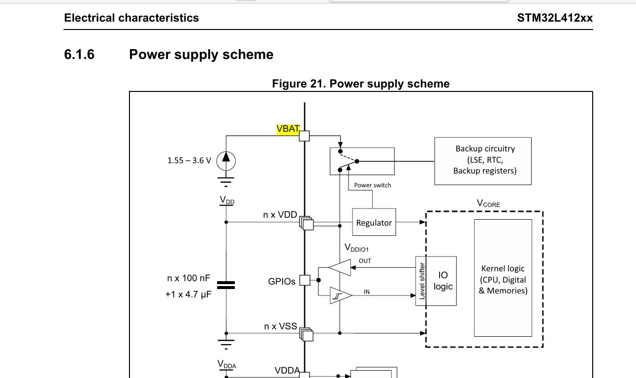

Richard Li
Senior
Oct 24, 2024 7:33 PM UTC
@Sujith,
Sounds your design no problem for hardware and software clock setting, problem is for power control or reset.
In datasheet 6.1.6 (See attached screenshot), this IC inside power path will switch between Vbat and Vdd.
Normal usage, user keep Vbat on, Vdd will on/off, in your test case, this two on same time, this may cause reset problem, system can't reset to default.
I suggest you check two cases (Vbat and Vdd seperated; Vbat and Vdd connect together) registers value, pay attention for reference manual (Attached ) page 131 and reset default value.
Regards,
Richard
