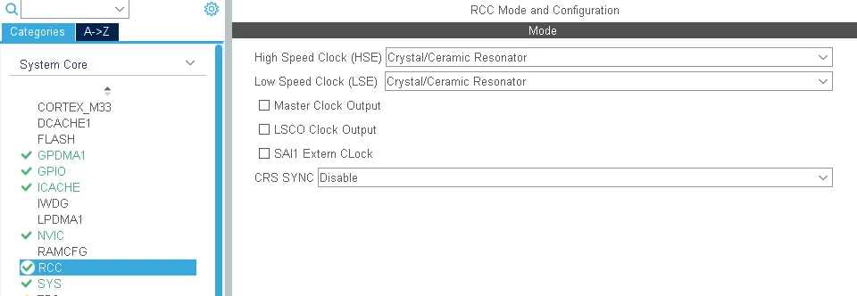

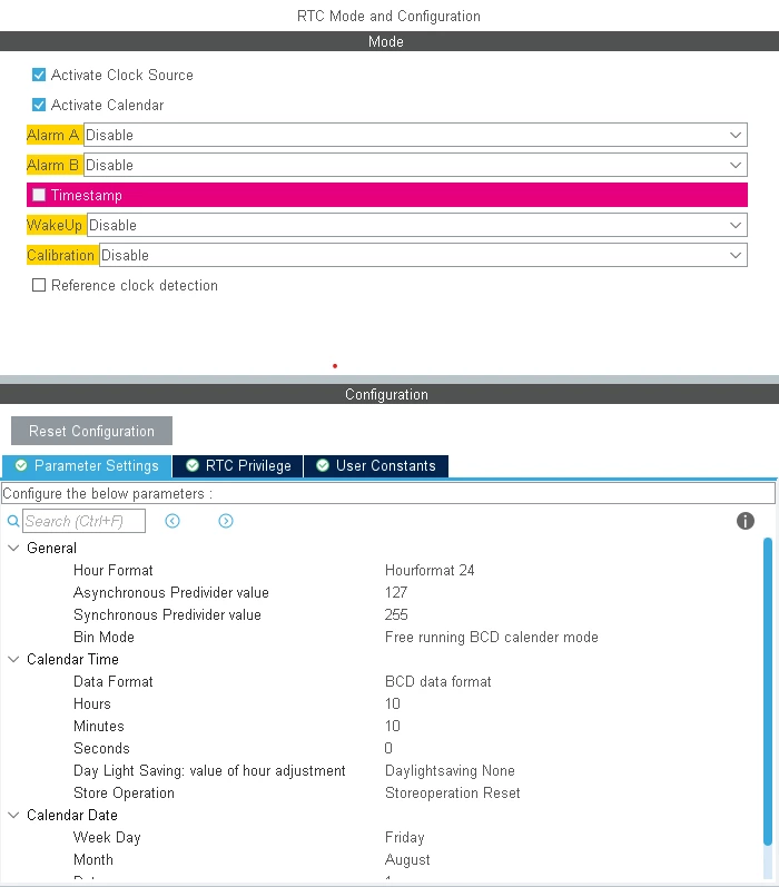

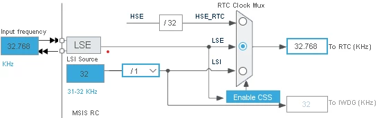

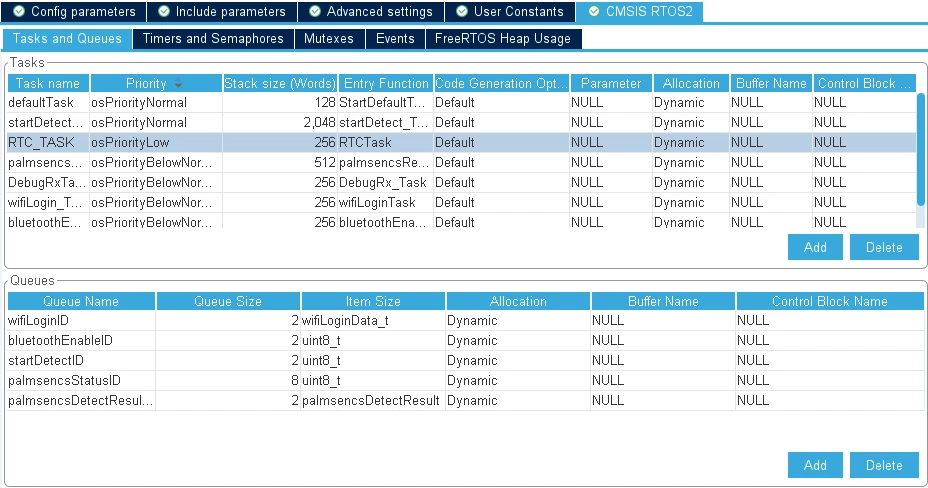

We are trying to enable the RTC with FreeRTOS on the STM32U575AII6. The settings are as follows:
1.RCC
2.RTC
3.Clock
4.freeRTOS

The seconds displayed above are wrong.
Any suggestions would be greatly appreciated. Thanks in advance!
TDKBest answer
Aug 6, 2025 3:56 AM UTC
Is the rate of printing (once per second) correct?
If you clock it with LSI, does it work as expected? If so, LSE isn't working right.
2 replies
TDKBest answer
LeonSuAuthor
Aug 7, 2025 1:24 AM UTC
Thanks @TDK
1. Is the rate of printing (once per second) correct?
YES.
2.If you clock it with LSI, does it work as expected? If so, LSE isn't working right.
I tried to switch the RTC clock source to LSI, and it’s working well.
Thanks again.
