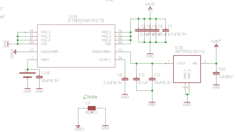

I am working on RTC of STM32F401RC. I have connected a new CR2032 battery to VBAT.
My problem is that when I restart the power I lose time. I have disabled the calendar generation and setting time manually so there is no possibility of time reset due to SW. Apart from that, I also tried to set the backup register and read it after power restart, the backup register also resets to 0.
To make sure I also tried on other MCU STM32F407, and it still has the same issue. The RTC circuit for both F401 and F407 boards is the same and are populated on my custom designed boards.
In order to make sure the battery is not the issue, I used a new different battery, and also tried powering VBAT using 3.3V derived from different board and still the time gets reset.
Here is the schematic of my RTC circuit.

@waclawek.jan Thanks for the reply.
VDDA/VREF+ are connected together and are powered by using a separate LDO power supply. This is done to keep analog and digital voltages separate. Also, I would like to mention that VSSA/VREF- are connected together and are shorted to digital Gnd using a choke. This is done to keep analog and digital Gnds on separate sides (but still connected using choke).
Here is how the supplies are:
The please note in the image below VSSA/VREF- are on separate GND node and the choke L3 is used to connect both the digital and analog Gnds.
GLASS
Visitor II
Oct 22, 2023 3:47 PM UTC
Seems that vdda is not correctly decoupled. IC10 is on GND and not GND1.
having a digital ground "separated" from analog ground is a good routing practice to avoid high speed return current from digital altering analog ground. But Agnd and Gnd MUST be connected with LOW impedance in one point (Star).
F4 need that vdda is "near" vdd. Look at datasheet. So may be give a try shorting L3 and deliver vdda from vdd through a choke. Not using a dedicated LDO that is challengy to guaranteed vdda "near" vdd as required by F4...

Thank @GLASS
That was a really good find. We really missed and should have kept GND1 as reference GND for the regulator IC10.
We have previously used VDDA and VDD by only having a choke in between them, however using a separate supply for VDDA has really greatly increased ADC readings stability.

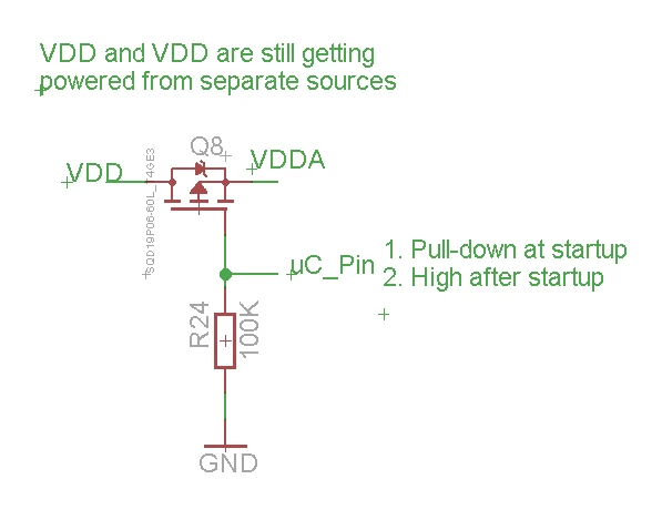

To confirm I get you correctly, Is this how you want me to test your 2nd option?
In this, I am considering
1. VDD and VDDA are still getting power from separate sources.
2. Keep mosfet pulled down at first and then give high to disconnect both the supplies.
AScha.3
Oct 22, 2023 3:17 PM UTC
right.
mos could be something like this: SI2367DS-T1-GE3  sot23
(at mouser: 30ct, 66 mOhm rds-on)

As suggested, adding anti parallel Schottky diodes between VDDA and VDD worked and my RTC is now able to keep time after power restart. It seems that it was indeed the issue of that  ±300mV difference at the startup.
I could not test Mosfet solution yet as I am unable to adjust the mosfet ckt near those 2 supply rails. However I will  certainly test it and share my results here as I feel going for the mosfet will give me better balance between RTC backup and ADC stability.
